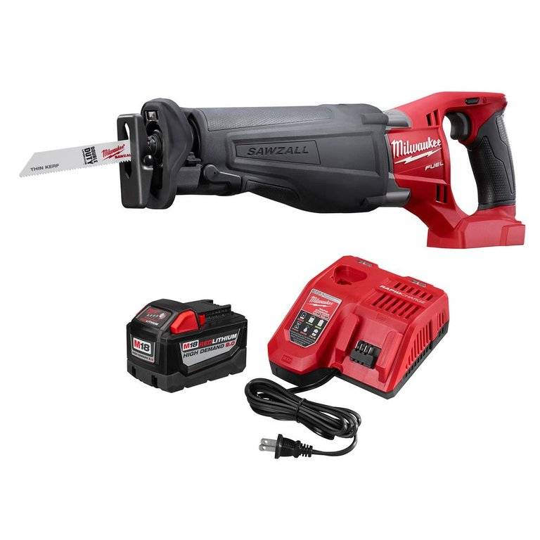

I have the Milwaukee Fuel 18v. Its awesome. I think it was 250 bucks with the 9 amp hour battery from MSC. They claim it will make like 92 cuts through 2x12 pine on a charge.

I have this Milwaukee saw. Works great, powerful. Can get 9ah batts...
