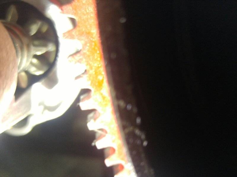

Well I think 67Dart273 is right, you do need a 727 converter. After going through the trouble of cutting open the 98 dakota transmission converter (which I believe is based on a 904, correct me if I'm wrong ) its not even close I wish I read 67Dart273 post before I did all that :BangHead: .
The bellhousing is out of a 70's A body.
