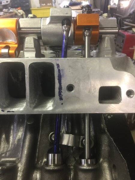

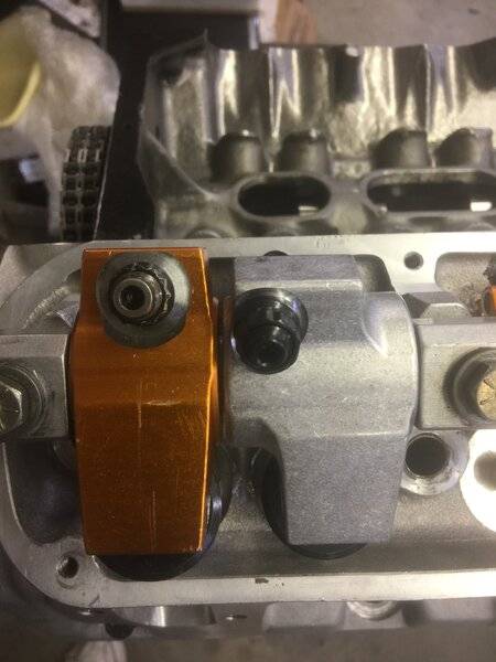

Ok I dummied these head on with the new rockers today before I hopped on cutting my grass before it rains again. Now I have something I can work with and room to spare. Should be drilling some holes next week if I can get out of my shop chair.

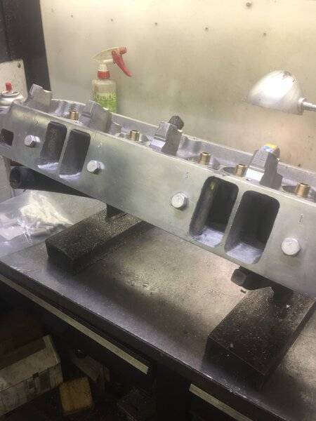

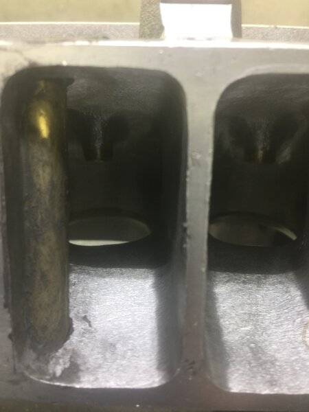

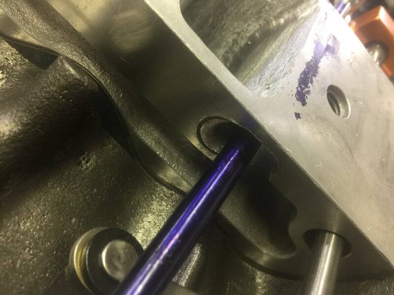

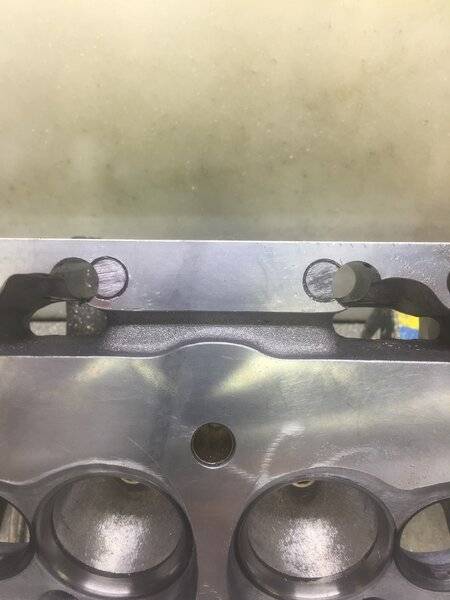

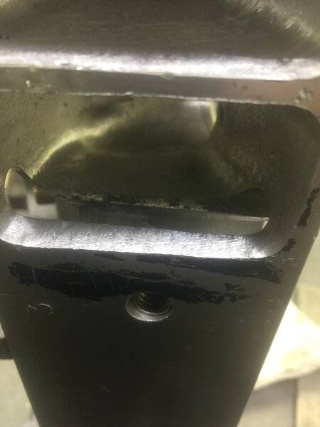

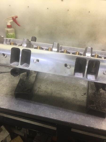

Ok finally some forward progress. I know a few members (yellow rose) and others were interested in using W2 (.750 offset) or other offsets to their Edelbrock or Speedmaster heads. My advice from someone traveling this road don’t go crazy as it’s not an easy road traveled. Going backwards if I remember right you can go slightly over 1.010 kissing a bronze tubed hole. I’m at 1.300 with a solid aluminum rod and relocated pushrod holes. Without a mill using a drill press like I did is rough. The first hole I did was covered earlier drilling into the port and having me reweld the hole and order another set of custom 1.6 Harland Sharp rockers and moving it over. The first set were .350 and the second set was .550 offset. The second hole I drilled grabbed the tube as it broke through and ripped the epoxy lose. F me and I stopped working on them for two plus weeks. Me and my great ideas.
As I told most of you before this job with the bigger port opening was planned around one of my Indy intakes so a couple of years ago I redrilled it with an Edelbrock pattern to match these heads. My friend had offered months ago to punch the new pushrod holes on his Bridgeport but stubborn John said ohhh no I can do it. Well John was wrong again. Lol. I retubbed the hole and drove over to his house. Laying out the needed angle we soon discovered when moving the pushrod holes over we were going to hit the Edelbrock intake holes so he said order some 3/8-1 inch aluminum bolts from Fastenal in Indy, locktite them in and we would lay out the new pattern. He’s a picture of how much aluminum rod I have to grind back out.
So for 4.5 hours Friday night and 5 hours Saturday night my buddy and I knocked the heads of the aluminum bolts and faced them, laid out the new Indy intake pattern, drilled then, I hand tapped them, then we set up one head to relocate the new pushrod holes. Each head needed reset twice for the four holes on each head. We milled a 5/8 hole so now I will debuted everything by hand and test fit each and every (8) hole with rockers, test springs, and pushrods. Would I recommend doing this. Aaaaaa NO. Will I do it again? Probably because I have the other set of .350 rockers. I would probably open the port to a max of 1.150 and knowing the 5 degree pushrod angle could probably do it on my drill press. And shirt between the port and stock Edelbrock intake pattern but I would do some port measurements on my Super Victor intake.

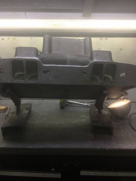

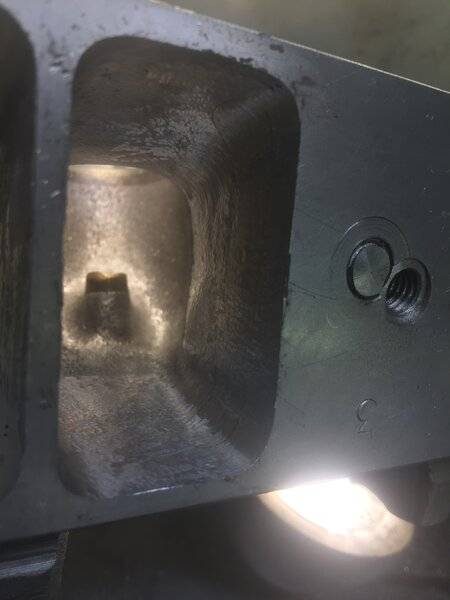

Wow finally back making some forward progress. Been trying to get moving and motivated and in shape for three 20,000.00 races the third week of August. Working on other people’s stuff is motivating me too. I finally opened up the port I ripped the aluminum tube out trying to drill pushrod holes with my drill press and with one head clearances for pushrods I can now do this one and move on. I know I can hit the 330 cfm mark but it’s time to move on with one more flow test. 227 plus and I’ll do some more Indy intake flow testing to see if it holds close to that number. It’s time to finish this dog gone engine and get it installed so I can rebuild my 422

Wow I forgot all about this post till a member tagged it in one of his posts. All I can add to update this is what a total failure at this point. I know I made another post about my adventure but come fire up time my engine was sucking oil bigtime. I pulled the Indy intake off and threw another intake gasket on it with the same result. So I removed the Indy intake and heads and did a quick Neway cutter valve job to my
Old open chamber best set of Edelbrock heads and put it together with a Victor340 intake I ported. It set the timing and went racing. My first break in pass was a 6.07 at almost 112mph. Best pass was a 5.98 with my son driving. And a 6.005 a couple weeks ago in summer heat.
So those heads and Indy intake have been sitting unused ever since on my shelf. They maxed out at 227cfm but now I have a set of standard port window heads at 334cfm. I will take some time during my 408 rebuild this winter to set those heads and intake to see what’s up with oil sucking in the bottom of the intake port window. If I was to guess I bought the intake used so was it cut before I bought it. I know my block was cut and squared so maybe it just needs a thicker intake gasket. Maybe the angle between an Edelbrock head head and Indy intake is a hair different. With everything I’ve learned over the past several years porting this heads and not having a valve seat machine can I hit 340 plus cfm. Hmmmmm. Is this the right time to try a 2.100 intake valve.
