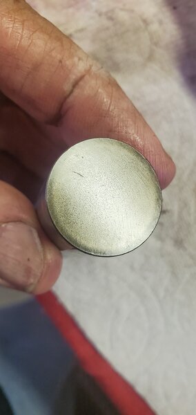

It took a lot to get the crap off. Now onto the freaking lifters... have minor nicks on the sides of some and maybe 5 of 8 have nicks on the bottom.

Thoughts on this nick?
They look to be, if they were in order they're fine to run but if you have any doubts replace them
Unfortunately, not in order. I was over on fbbo. Saw somewhere on one of the forums ( can't find it now of course) where you can send your lifters in to be resurfaced? Never heard of it but I read it earlier today for s&g's

Yeah that's a great option, especially with the price of new ones. I was going to mention that but my dog was about to take a **** in the living room and I hurried my post lol.
I think that if you are first worried about rust on the cam and now nicks in the lifters you are barking up a tree that needs to be barked at.
If you want advice from people on this form to see what you are looking at, Well that not gonna happen. They can not see what you are seeing.
I could be in on the cam but damaged lifters???
Its your motor but I would not run them and I am freakin cheap.
Wipe your cam and you are out the cost of lifters before you even replace the cam and lifters due to coolant, gaskets, Oil etc.
Just my 2 cents.
Most cam failures are due to lifters not rotating.
Damaged lifters are probably not going to rotate.
I have some used lifters that I will give you free of charge that look better.
