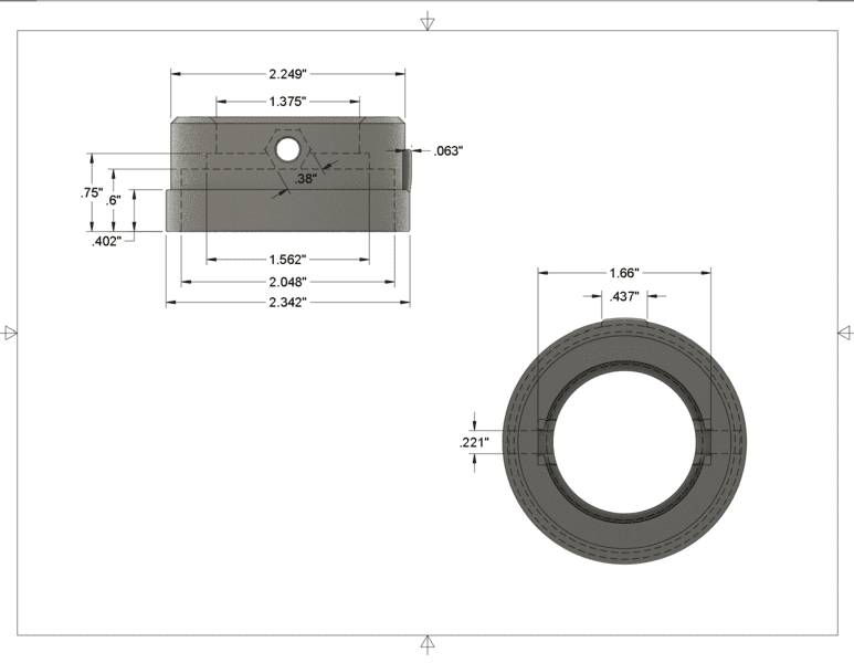

I have posted a similar part in forums on here recently, and there was more interest in it than I thought there would be.
If its going to be something I offer for purchase, I thought I should make something a little more up to finished product standards.
This is almost a complete redesign of the model from earlier posts, addressing some dimensional strength issues.
If there is someone out there with an early 67 steering column and a set of calipers, it would be awesome if I could verify some dimensions,
Here Is what I have until I have more parts in hand...

I have reviewed the measurements and everything looks good to me (although I'm using a cheapo caliper). It would be great if someone else could also check them.

Thanks for checking! You are the second one, but I wasn't too confident in the last persons measurements. One dimension I don't think I have written down on the spec sheet, is the OD of the tube.
Kind of nice to see that I can reach tolerances of 0.002" with this printer.
Just received the bearing, and it's a perfect press fit... Just able to press it in by hand. As long as the ID of the tube is good, and all the dimensions for the keyway and screw holes are good. This should engage the two really well. This also means I'm going to be able to ship it assembled, with this nuts captured inside.
The outer diameters as I measure them are:
Outer tube- 2.39"
Inner tube (lower end at bearing)- 1.36"
Steering column (at bearing location)- 1.00"
The screw locations look okay to me. I measure the distance from the end of the Outer tube to the center of the oval screw holes as .50"; I think you have them in the bearing retainer as .54" from the lip, which should be fine (I think).

You may want to confirm that this is the part you are looking for. As far as I know, this is a 67 only part. Although, if your steering column shaft end looks the same as the renderings and pictures in this thread (2.25"id, 1" shaft, and the 0.5" keyway), this is the part you need.
