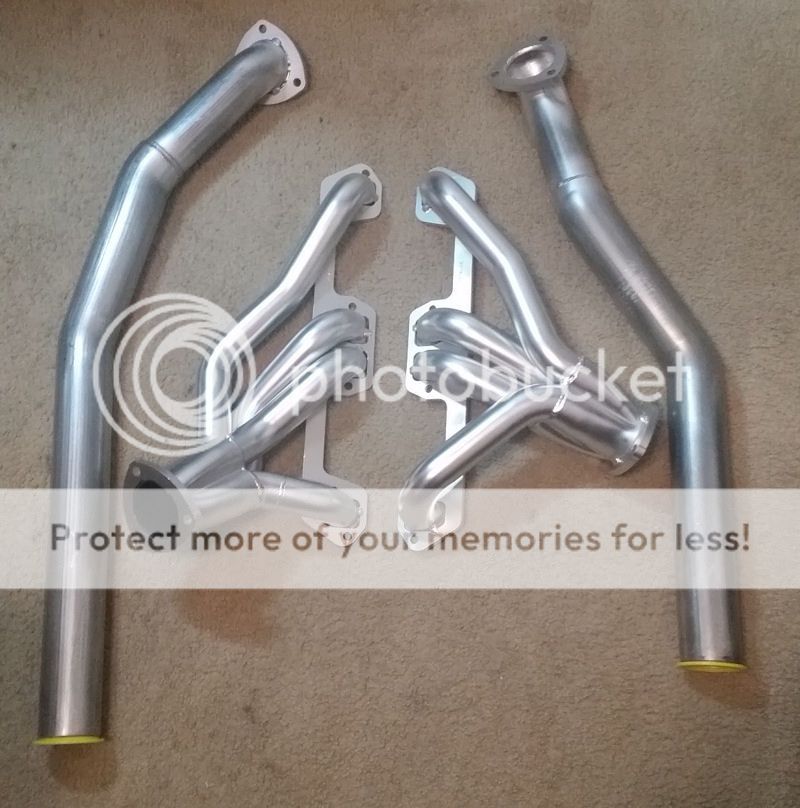

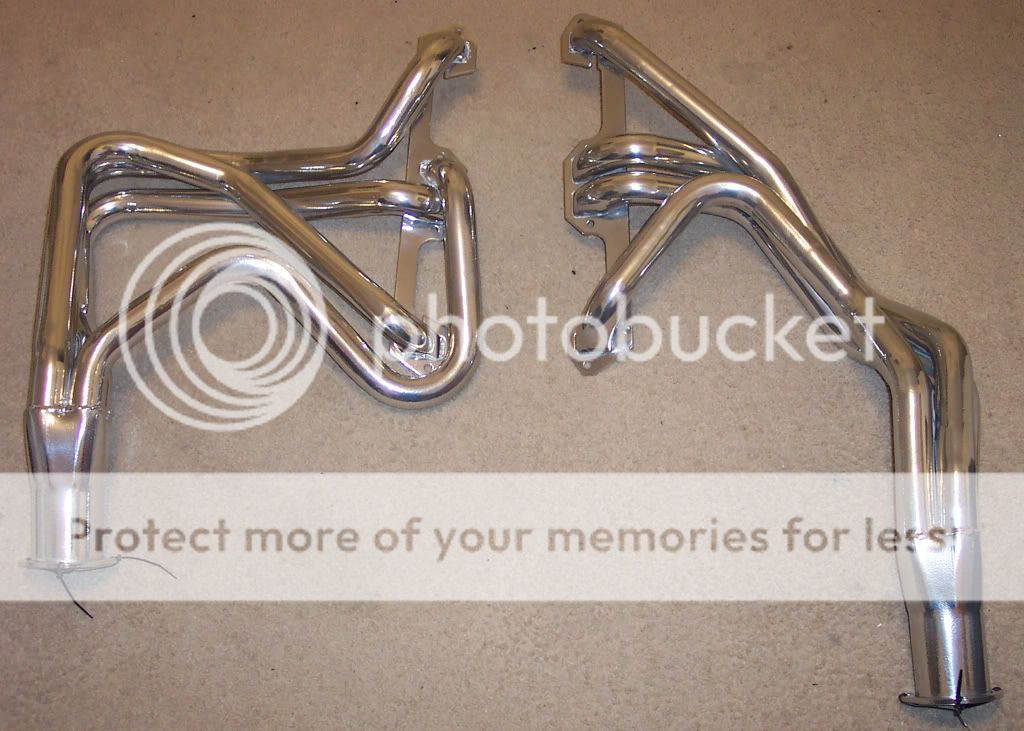

Long story short: I got a set of brand X long tube headers when I bought my car as a rolling chassis. Short on money, I used them, and amazingly, they cleared everything, even the factory power steering (damn!). Over time, I removed the P/S, factory starter, and got the headers ceramic coated while I had the front suspension torn out of the car. Unfortunately, the one thing they DIDN'T have was good ground clearance. several bad hits, and now they are leaking and rubbing the steering components in all the wrong places.
This is what they looked like from the local ceramic coating shop..11 years ago.
Out with the old, and in with the new. My car isn't any kind of crazy power house (just a massaged 360) so I opted for driveability over absolute power.
Those flanges look beefy.
When you put these in, kindly take some shots along the way and of course finished. You can just add 'em to this thread

Would love to see what the clearance looks like with these installed.

I put these on my '69 GTS . I would suggest attaching the adapter pipes to the headers before putting them in the car.
Also, if you have an automatic, there is really no way to use the stock kickdown linkage. You can either modify it or get a Lokar cable,which is what I did.
Other than the above, just follow the instructions and you won't have any trouble at all installing them.
