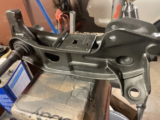

I accidentally faked cosmoline on some lca for my dart. I painted them silver then clear coated with rattle can clear. After several years the clear yellowed and it looks just like cosmoline.

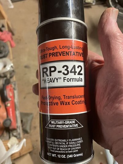

I done these with duplicolor metalcast
I used the Cosmoline in the spray aerosol can for my LCAs
