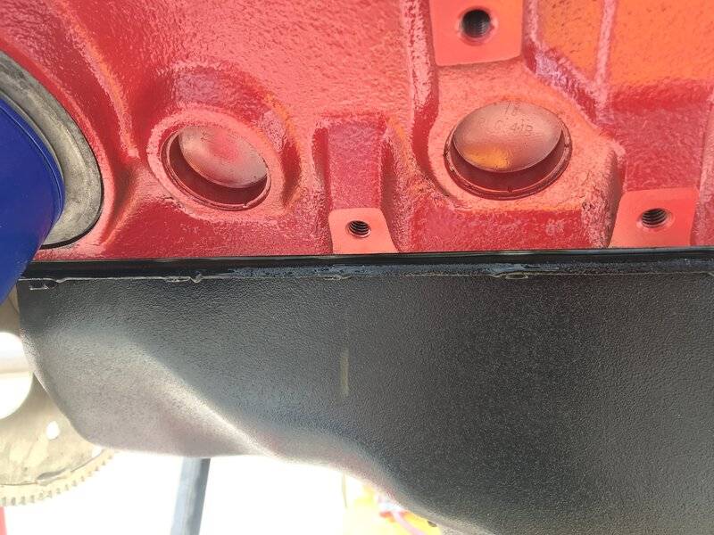

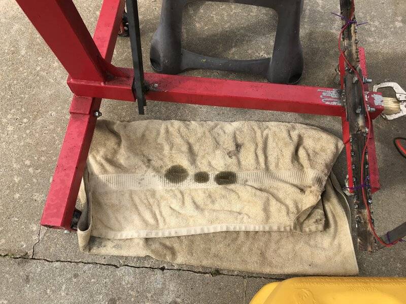

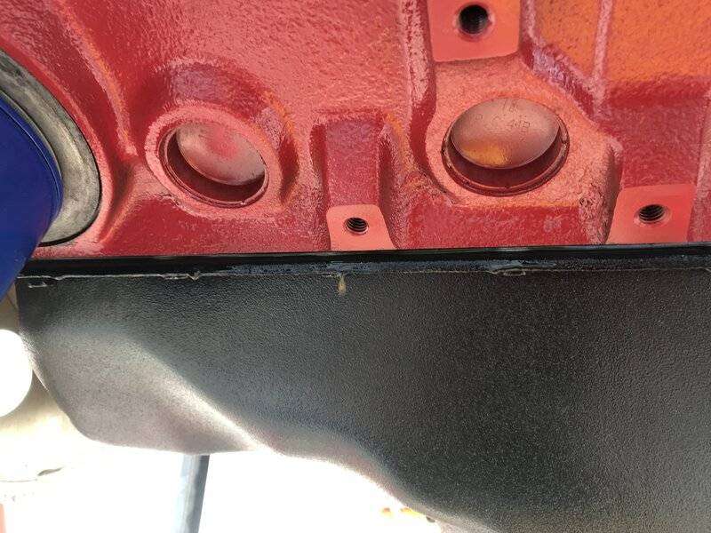

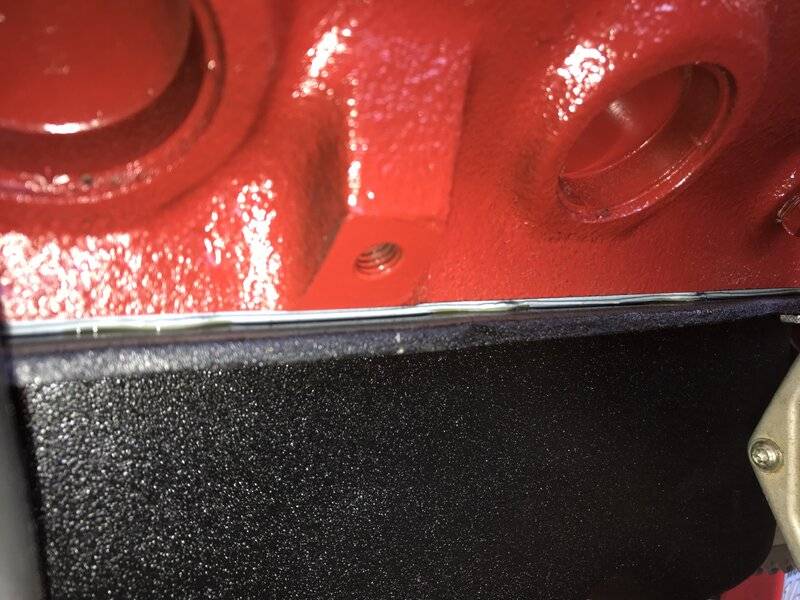

Oil Pan leaking, one side only!!!

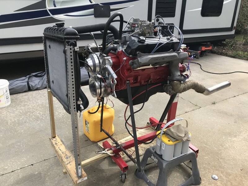

The toughest part was working out the starter mounts as I didn’t have an old bellhouse to use.
After I fabricated a bracket mount pretty straightforward from there.
It’s an engine stand converted to a run stand. I made so the front mount brackets can be unbolted and converted back to a regular stand when needed.
I found a thread for the original build - maybe - lots of photos
Build That Engine Run Stand
It’s working in the areas where they give you trouble if you don’t make the mods.

Does the windridge tray go on seperate to the pan?
IIRC some windridge trays are seperate on some motors.
So the install would be gasket tray gasket pan.
Just reaching for straws
Small block windage tray bolts to the main cap fasteners, not the oil pan rail.
I have had Milodon windage tray studs hit the pan and keep it from sitting flat against the pan rail, but I assumed he used a factory style windage tray from the description.
Because I don't know....
Yes sir, the tray mounts to your main caps and the pan is separate.
A w/tray is different on 360 vs the 318-340, because of the main caps are different, you have to have a w/tray that is slotted where they mount to the caps to allow for an install on the 360.
So the install is W/Tray, Gasket then Pan.
The W/Tray never comes in contact with the Gasket or pan.
The W/Tray has to be installed before your Oil Pump also so you can set you pickup height in case its to close to the Tray.
It's a factory style w/the slotted mounting holes, I bought from a member on here a long time ago.

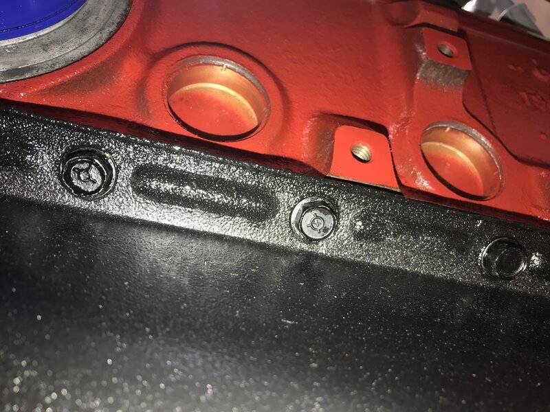

Put Aviation Sealer on the bolt threads, do not put them in dry.
The oil will "Wick" down the threads when they are dry.
UPDATE…. Problem Solved!!!!
The Bolts I was using were for the Magnum Motors… made sense to me to use what it came with it!!!
Wrong!!!! The OEM Magnum Bolts are 7/8 in length and the OEM LA Bolts are 3/4!!

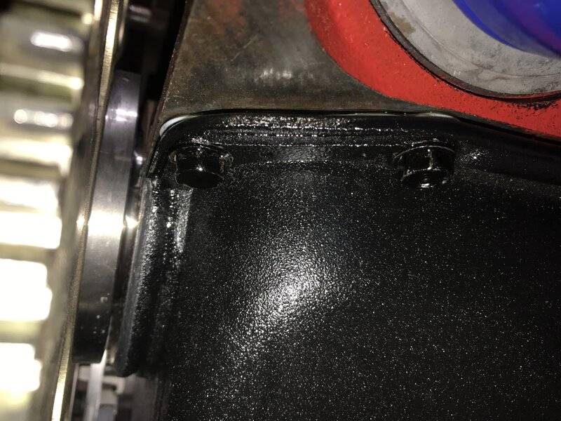

So the were tightening just enough but not quite sealing the pan along the sides and would leak only once it got up to around 180 degrees.
On the Front and Rear where they go all the way through… no leaks!!!
So, installed the correct length and now no issues!!!
Thanks everyone for your help with this issue!!!
