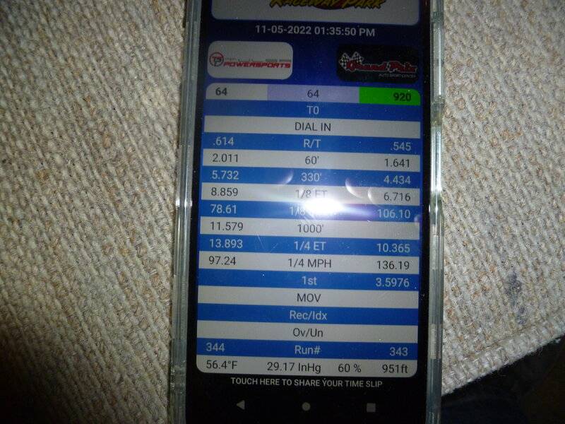

:thumbsup: How well did you hook up with the street tires and open rear? Its crazy how similar our ets are with many of the same parts (stock bottom end , Summit 272, bowled blended stock heads, Dougs headers , 9.5 PTC converter). A lot less miles on my short block ( about 80,000 ) than yours .Mine was LD4B and 650 dp, 3.23 suregrip with 275/60 ET Streets and I have a sealed air pan to the scoop. My converter flashes to about 3500. Was a nice cool day when I ran. My et slip for comparison :

I wasn't spinning, but I was aware of my situation and left the line accordingly, if you know what I mean
