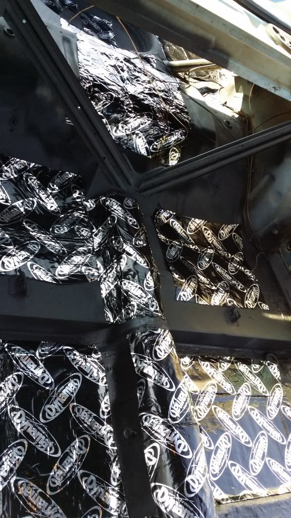

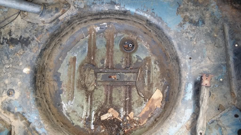

More work on the Dart today.
The trunk was pretty grungy and I figured the rest of the interior was the same under the carpet.
Step 1 - Wire brush everything to loosen crud and vacuum
Step 2 - Simple Green and wipe down floor
Step 3 - Rust Converter to help out with surface oxidation
Step 4 - Prime
Step 5 - Paint
Step 6 - Dynamat floor and dynapad cardboard pass through.
I also installed 3 pt retractable seat belts to replace the old green lap belts. New seats will be here in a few days.

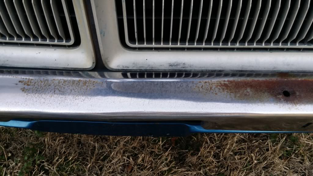

On the outside I tried a trick someone told me. Aluminum foil and coke " I used coke zero" to remove oxidation without scratching the metal underneath. My front bumper is HEAVILY oxidized so I figured I had nothing to lose if it messed it up.
This is after about 10 minutes of polishing. At this point I was wore out from the rest of the day and called it quits. I'm impressed with it and will finish it out when the weather clears back up.
Test spot
Bad spot before
Bad spot after
