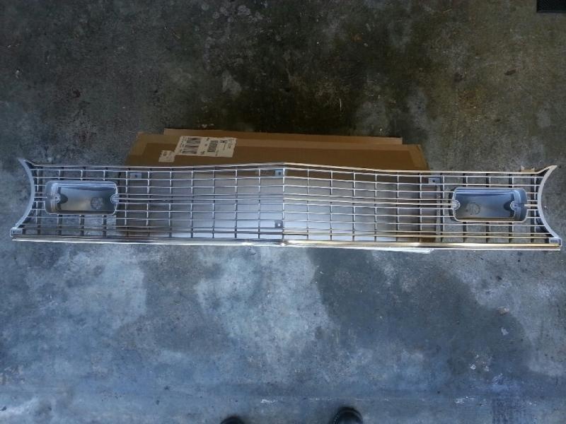

I am going to redo my grill and finish panel on my 68 dart and was wondering what would be the best way to remove the paint so I can repaint. thanks for your help on this!:hello1:
I just washed & degreased, then hit with a red scotchbrite pad to score & shot it with three coats of Mopar Argent. I'm very pleased.
attachment.php
get a sand blaster, set it on the lowest setting and stand a ways back and dust the grill with it. This should take off the paint and not cause any damage.
