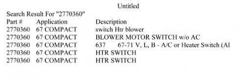

Can someone verify for me that this AC/Heater switch is correct for a '67 Dart with factory AC?

It looks the same as the one Okla posted...it sounds like it is numbered incorrectly....make sure the company has a return policy..
I'm thinking that since the blower switch bolts onto the climate controller the switch alone would be the same. The complete controllers would be different.
The shape of the lever on the blower switch changed from the poke an eye out stem to rounded ( similar to a thumb wheel ) in 68 up cars.
That's what I was thinking. The blower controller would be the same but the climate controller would be different. I have a climate controller just not the fan switch. I just don't want to buy something I'm gonna have to return.
The number is clearly stamped on the item, so it's advertised as that part number correctly, it's just a question as to whether or not that was used on ac cars. Anyone have one they can check?

After much looking, I believe it is the same switch for AC and Heater blower, as described above. I will let you know if it works for my application.
For this reason:
2770360 67 COMPACT 637 67-71 V, L, B - A/C or Heater Switch (Al
