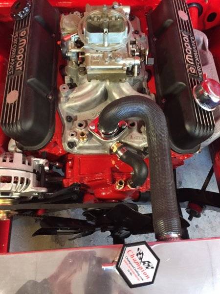

Here’s a picture of our upper hose. Bought from Rockauto for a 68-69 dart. I’ve always preferred this shape/routing for all my small block hoses.
Hope This helps.
