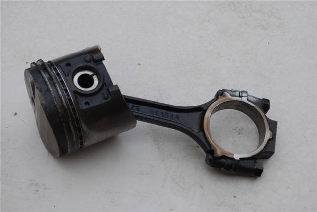

I just removed my 920 heads off the 66 273 dart. I'm trying to thread to help id the pistons. They have 4 valve reliefs and say 040 on the dome. I'm really mostly curious what the 040 means and it there is any way to tell if they are stock
Generally if a part has a number like 010, 020, 030, 040 this is the oversize label. I would bet that your engine has already been bored out .040 over factory bore. I don't recall how much oversize a 273 can take but I think that is around the max.
4 valve reliefs means its a 2 barrel engine....040 means its been bored 40 thousandths over factory bore.
Below are 2 barrel pistons...std. size.....
65Val is on it, +.040 and 2bbl: no 4bbl pistons have 4 reliefs. They have 2 and a 3 sided dome. Great pic here from FABO member ???

Sweet! So my 273 has the good 920 heads, is overbored 40, this is nice... I'm guessing it doesn't have a stock cam, can I ID the cam with it still in the engine?
