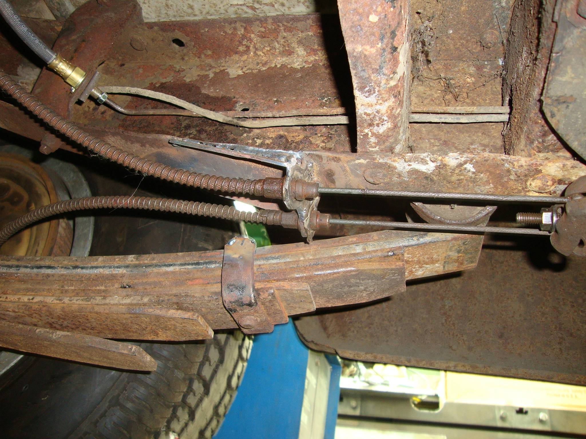

that what i did on the 60 d100 inner fender exit , the 64 d100 is getting a modified set up i ran on another . also the rear spring package is a bit weak to the weight . i build up the rears for the handling as well
