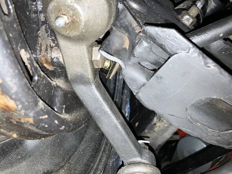

Second question since "stops" were mentioned. I notice my brake hoses are pulled pretty tight when I go full right or left. Is my "stop" missing something? Or is that bolt head really the only thing that limits it?

What lower ball joint is that? It doesn't have a steering stop at all. The "nub" circled in this picture is the steering stop. They vary a bit from one manufacturer to the next, but it should have one.
Thank you. What year is that from? I looked on Rock Auto and I don't see that nub on any of the 69 Dart lower ball joint pics... I got mine from ESPO.
The picture is a 73+ disk lower ball joint. Wasn't sure what year car we were talking about, kinda assumed from your screen name it was 73+.
You're right though, the earlier cars don't have that steering stop on the lower ball joint.
Ha. My bad, I should have put my car info. I was made in 76! Car was made in 69.
