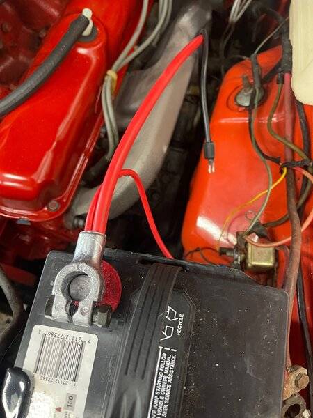

I just purchased a new pos battery cable for my 71 Demon and was looking for someone who has a pic of the connections next to the battery. Mine has an extra black cable lead at the top close to the battery post that the old cable did not have.
Thanks much,
Mark

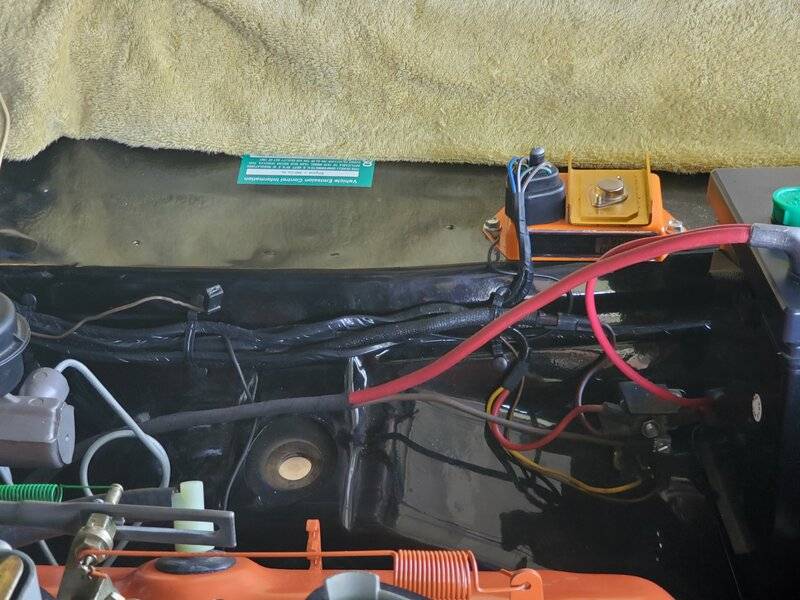

Pictures would be awesome of what you have.
This is the best I have for photos of my 1972 Dodge Dart.
An extra small "black" negative cable goes to the nut plate at radiator support near the backside of the headlight.
Here is a picture of the new Positive cable and the black lead with the spade connector that I'm not sure where it connects to.
Thanks,
Mark
The black cable should connect at the small stud at the starter and at the "square screw" connection on your starter relay
The extra, smaller red should connect to the "big stud" on your starter relay
And ALWAYS remember---black is not necessarily ground. It is NEVER ground in AC wiring, and "sometimes" not ground in other / auto wiring. (The output of your alternator is black)
Got it thanks. The old pos cable had a green wire going to that flat headed screw plate. The new cables lead is black. Thanks again for everyone’s help!
