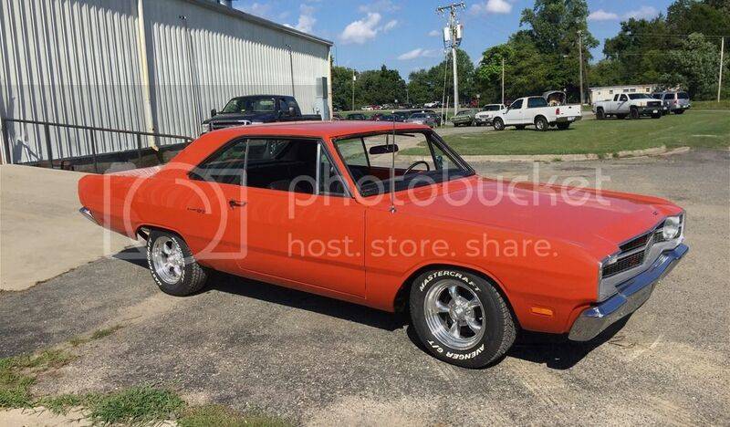

Wheels: 15x7 American Racing Torque Thrust SBP (all four corners)
Backspace: 4 1/8"
Tires: Mastercraft Avenger GT 215/65R15 (all four corners)
Front suspension: Stock
Rear suspension: New Springs N' Things Leaf Springs (stock height)
KYB Shocks on all four corners
:thumbsup:That is not a car anymore! That is a masterpiece! I would be afraid to drive that. That is too nice congratulations
