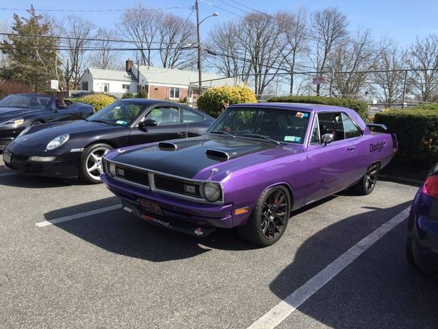

I would guess 18 up front 20 in the back. .
Nothing that hasn't been done before, but it's mine.
