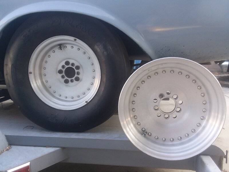

The loose wheel is a 15x10.5, 7.25 backspace, (15x7 front half, 15x14 rear half) double drilled for 5x4 and 5x4.5. Wheels on the car are 15x8.5 with 10.5x28 slicks, 4 7/8 bs. also double drilled.

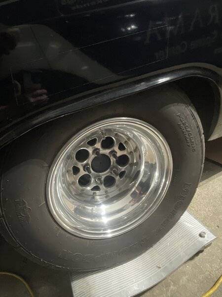

Here’s what’s on the our car now.
View attachment 1715866657 P325/50/15 fenders not cut yet, I just had shoulder replacement, not sure on backspacing “ just collecting all my parts definitely want a taller tire 30-31
You have the ideal situation there. You have a set that fits, just see how much room you have to the springs/tub, and adjust the new backspace off the wheels you have now. So, if the wheels you have now have 5" bs, and the tire is close enough to the spring, just add the two inches to the outside, and keep the five inch bs. All measurements can be made from the wheels/tires you have now.

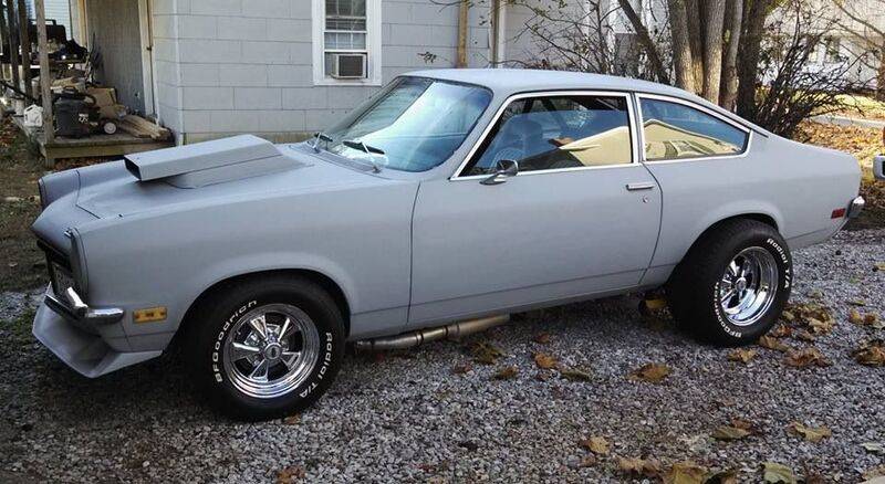

A friend of mine built a V8 Vega in the last century :rolleyes:. Used the narrowest 12 bolt he could find in it, which still left wheel and tire fitment issues. Ended up similar to this

A friend of mine built a V8 Vega in the last century :rolleyes:. Used the narrowest 12 bolt he could find in it, which still left wheel and tire fitment issues. Ended up similar to this View attachment 1715867993
