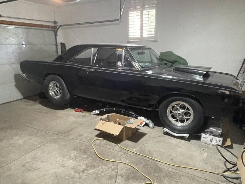

Cragar D-Window 15x7
Front: 205/60/15
Rear: 225/70/18
img_20220122_155450_143-jpg.1715858351
img_20220122_155450_111-jpg.1715858352

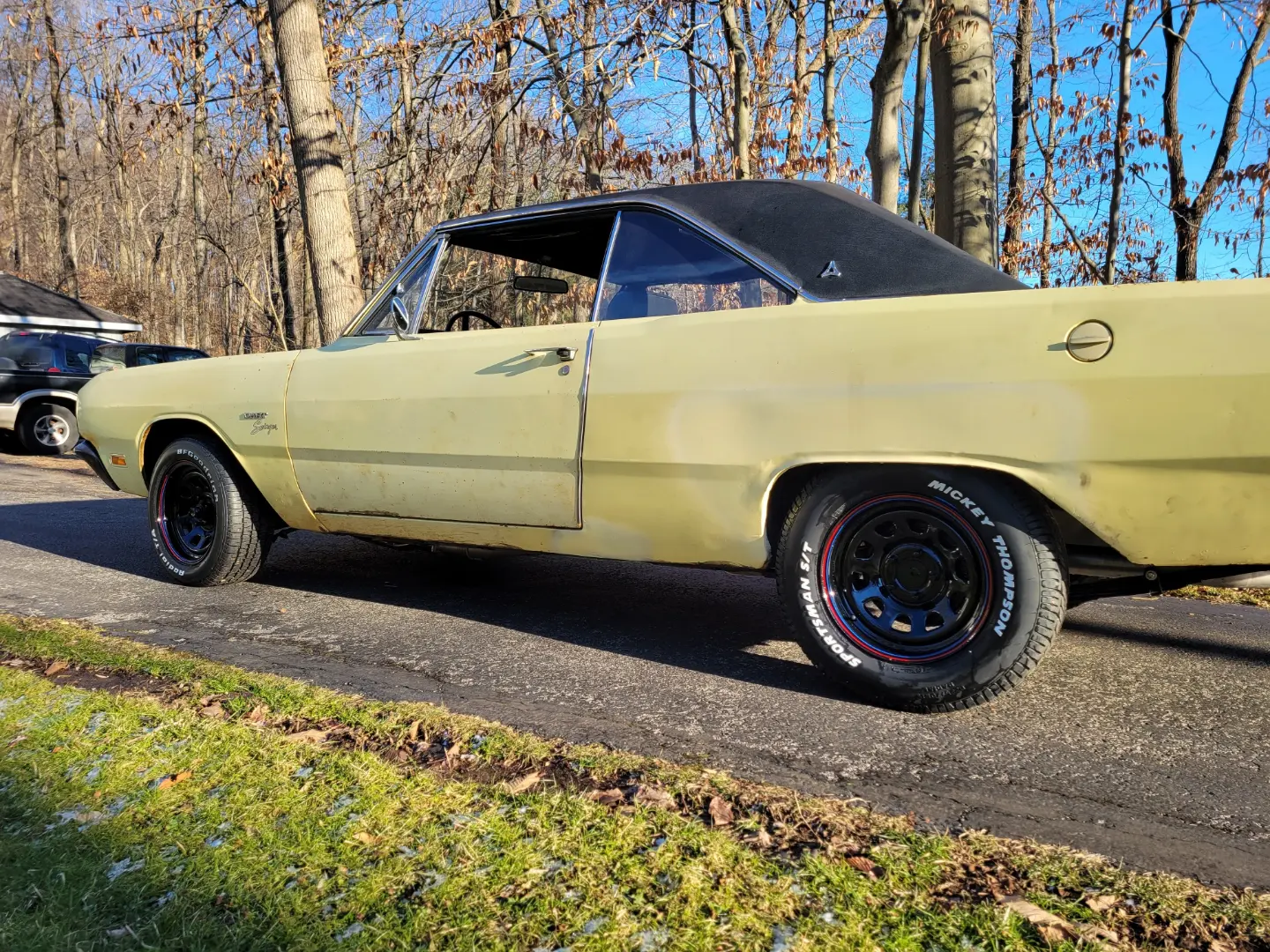

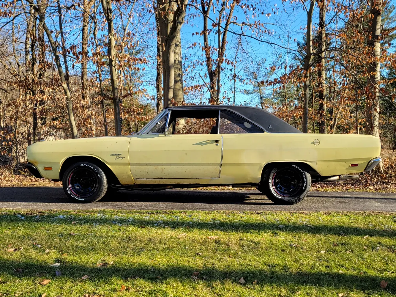

I threw these on my dart because I was cheap and I love the look now.
