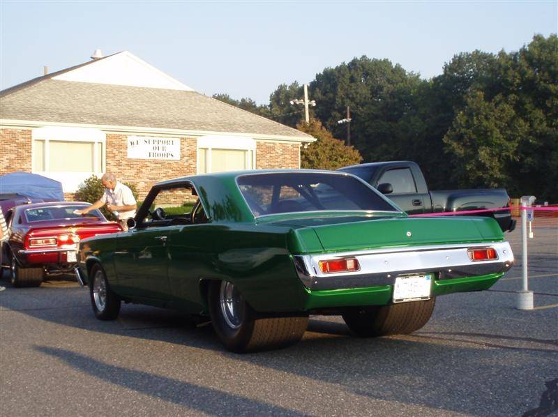

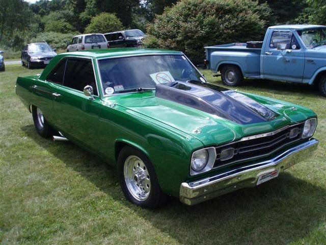

Front: 165SR15 on weld wheels frontend completely rebuilt with PST bushings over sized sway bar
Rear: 33x21.5x15 Mickeys on weld wheels. Fully tubbed 4 link, coil over, boxed frame.:cheers:

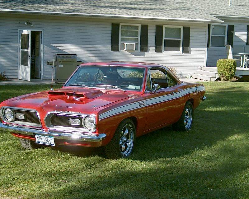

Stock 68 Barracuda fastback with the fender lip rolled a bit.
Front - 205/70/15 on 15 x 5.5 w/3.5 b/s, KH 4 piston redrilled to bbp
Rears - Had 235/60/15 on 15 x 7 w/4.5 bs w/11 x 2 brakes. Since then, I was able to sneak a 245/60/15 on the same wheel w/better than finger clearance to the lip and spring.

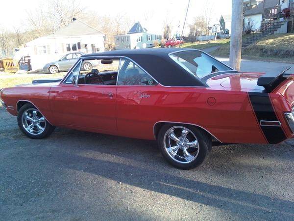

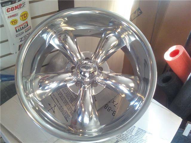

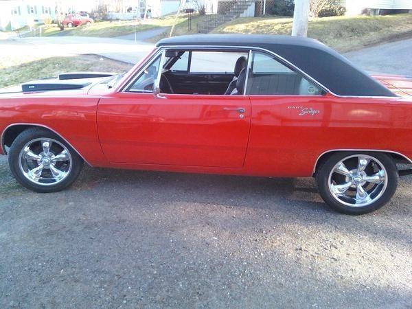

coys wheels 17x7 small bolt pattern 225/50s in front and 235/50s in the back they bolted right on with no issues great wheels 4.25 backspacing

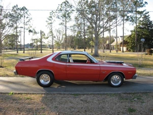

1975 Dodge Dart Sport
Front
Wheel Brand: - Summit "Pro-Star" knock-offs
Size: - 15 x 4
Backspacing: - 2.5"
Tire size: - 165/R15
Rear
Size: - 15 x 7
Backspacing: - 4"
Tire size: - 275/60R/15
The rears are a tight fit, but nothing rubs. :headbang:

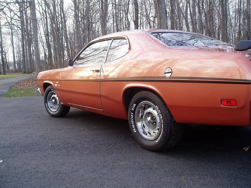

All Rims are Crager SS 5 on 4
15*6 " Front 3" bs
215/60/15 BFG Radial T/A
15/8 " Rear 4 1/4" bs
255/60/15 BFG Radial T/A
No suspension mods front or rear. Rear tire to spring clearance a little over 3/4 in.No noticable problems front or rear.
