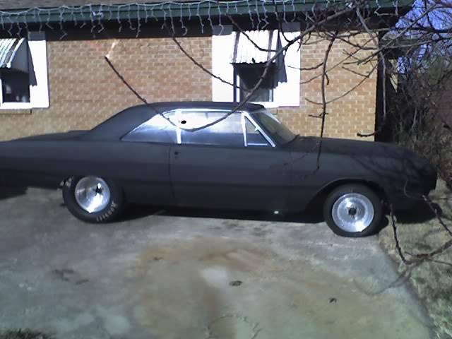

29.5 x 13.50 M/T on 15x10 w/3" bs Centerlines, Rear narrowed 46" & moved back 1.5". Up front to short 23.5" tall Moroso's on 15x3 Centerlines. Front tires will be about 2" taller in future.:toothy7:
