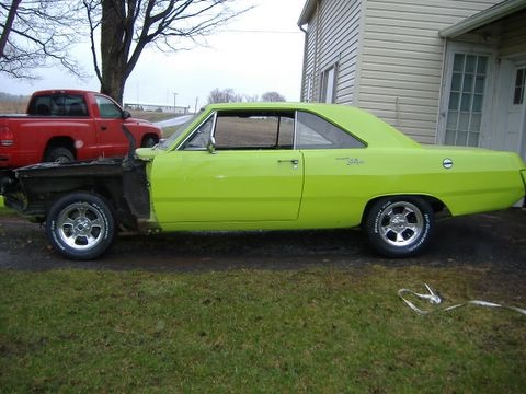

'70 Dart Swinger
Front
Wheel Brand: - Majestic 787
Size - 15X6
Offset: +6 mm
tire size: - P205/60R 15
Suspension mods: Front end rebuild and aftermarket sway bar
Rear
Offset: 0 mm
tire size: - P235/60R 15
Suspension mod: None

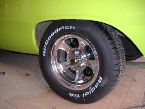

front: 15x7 copwheels 215/60r15 bfg t/a's
backspacing-stock?
rear: 15x7 copwheels 235/60r15 bfg t/a's
backspacing-stock?
no suspension mods
