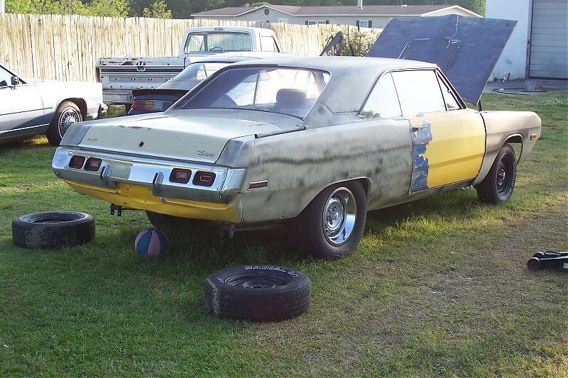

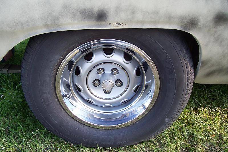

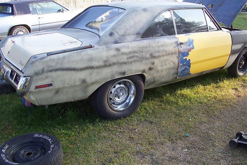

I am running a set of wheels from custom wheel market out of CA. The fronts are 15 x7 with 4.00 backspace and 215/60R15 bfg on the front and 15x7 4.00 backspace with 245/60R15 on the rear. Both are 4.5 bolt pattern. I am running a A-body 8 3/4 rear sitting in the stock location. The picture is of my unfinished car with the tires and wheels installed.
That's close to what my Valiant came with. I've since gone +4 on the wheels, and at least 3x more rubber on the ground. That Dart's gonna be sweet when you get her all cleaned up!
