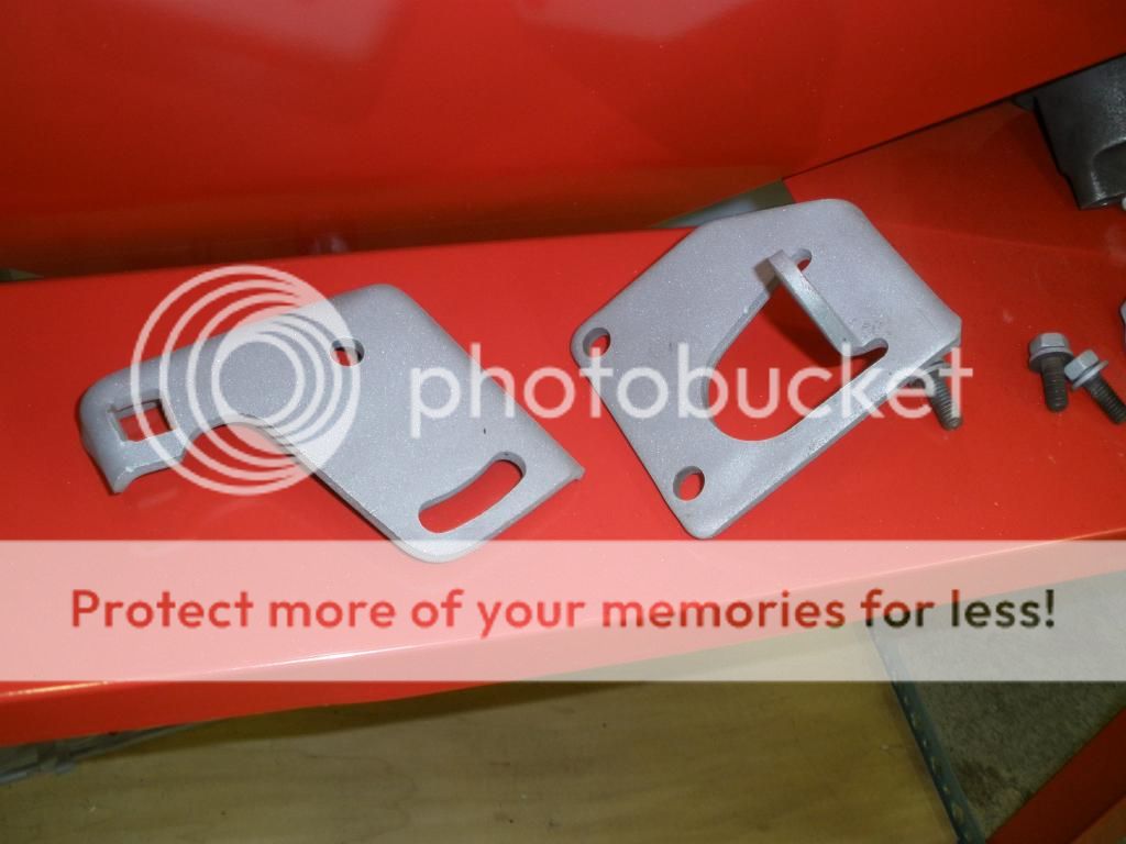

These are TRW brackets:

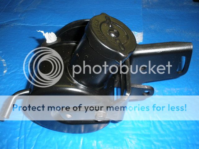

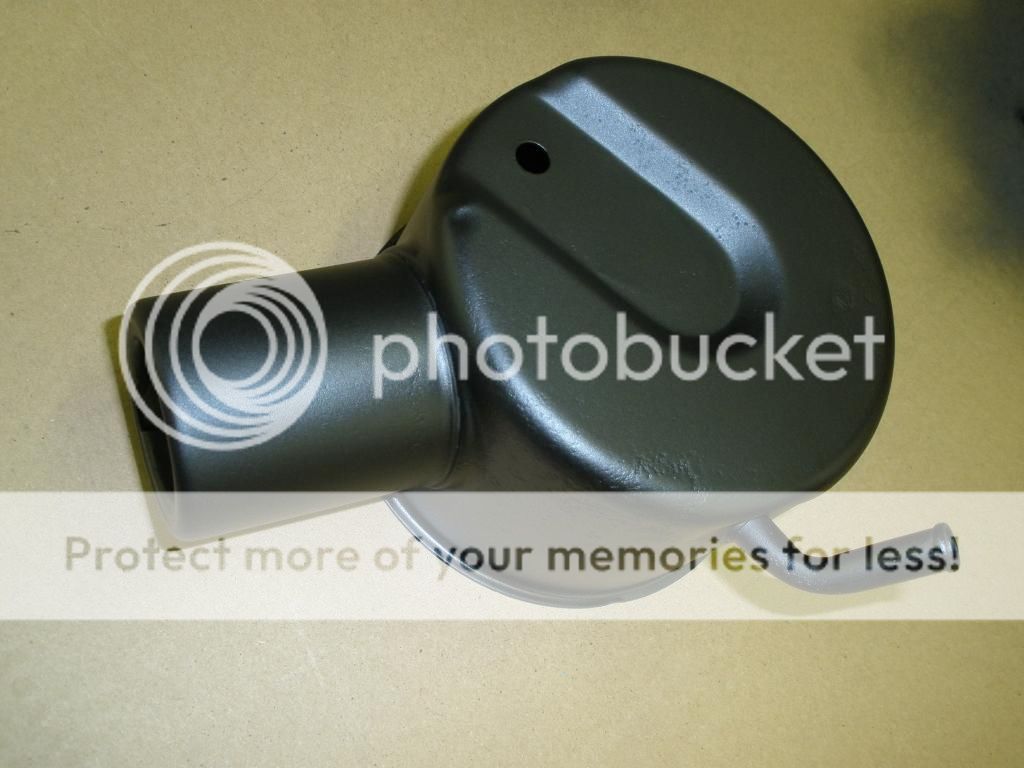

Mind only had one hole in the resevoir:
