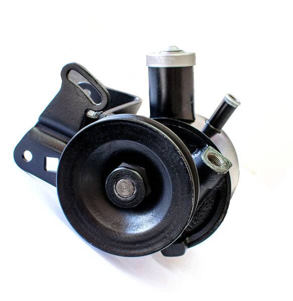

I'm helping a deceased member's wife make his 67 Dart more usable for her. That includes power steering. The car was switch over to a 340. He had installed a three belt crank pulley and got the right brackets to use with the cast iron water pump. I found a power steering box and the shorter rod for the steering column. I am puzzling over the correct pump to use for this. Was there only one pump used on LAs with cast iron water pump, and if so what is it?
Federal power steering pump.
One of our members was giving away a PS gearbox and pump for the shipping a couple of days ago. Unfortunately I can't find the link.
Not that one though....the one pictured is '63 and earlier.....probably off a poly 318. I'd use the late '60's Saginaw pump, pulley, and brackets if I was starting from scratch.
Pic was just for pump reference… his brackets may be different.
