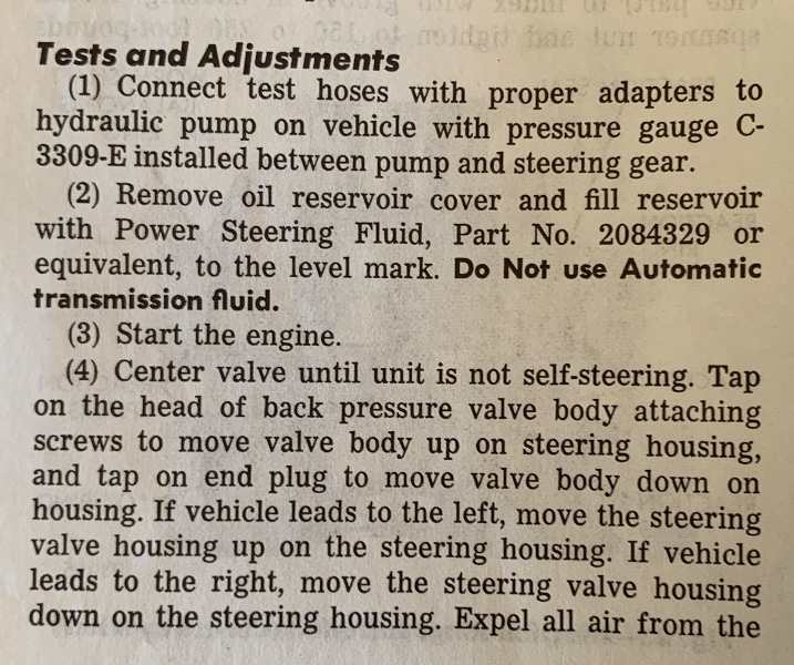

I did get the steering to properly self center. I’ve attached a photo of the instructions from the Chrysler manual to prove I’m not a total idiot. Nowhere does it say, “loosen screws“.

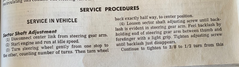

Attached is a photo from the Chrysler book on sector shaft adjustment.
I don’t see why it’s necessary to disconnect the center link. It seems to me that if while the car is running, you move the steering wheel back-and-forth very slowly and watch the left front wheel, if there’s only a hint of delay between moving the steering wheel and the wheel itself moving, then there’s no slack but that doesn’t assure the proper preload.

So the sector adjustment is complete, but the steering wheel still rotates counterclockwise just a little. I have loosened the two screws to the point of leaking and used a hammer and a rod to beat on the head of the screws with no difference. What now?

Thanks for the picture. We had this discussion a while back. If you are leaning over the fender, forwards and backwards (towards front of car and towards back of car) will seem to be side to side.
It's always possible that something is wrong with the valve, or dirt caught in there someplace
You have to realize these are a servo type device, a feedback loop, sorta like cruise control. They are easier to understand if you have ever seen the kind with a cylinder on the drag link, and the valve on the end of the tie rod. Corvettes used these until quite late. Don't know why, or when they quit. The valve has some play, so when you move the toggle it operates the valve, and the valve boosts the power. When you quit moving the wheel, the boost keeps going, so to speak, until it moves far enough to move the toggle "loose" (centered) and close the valve.
You don't beat on the head of the screws.... You lightly tap the valve body, it slides maybe 1/8" total but if it moves to either end of it's travel the wheeling wheel will be spinning till it hits the end of it's travel...
Look at the machined groove in the steering box picture below, the valve can only move within the groove....
Don't worry about the red arrow, pay attention to the groove, the valve slides in that groove... tap either end of the valve with the engine running & you'll see the effect... The tires should be off the ground... When you get it so it doesn't turn to either direction with the wheels in the air you are close... Shut the engine off & watch the steering wheel as you start the engine.... The wheel shouldn't move at all, if it briefly kicks to either side your adjustment needs further tweaking... If it doesn't move tighten the bolts & top off the fluid....
In the service manual they mention tapping on the bolts... What they are referring to are the bolt and cap with the red arrows in the photo below...

Good stuff. I understood the referenced screws to be the two that secure the valve to the box. “Beat” is an exaggeration but I did resolve the worst of the problem tapping vigorously on them. I’ll give it another try. Thanks.
