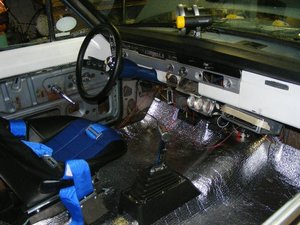

I hear ya on the lowerend,mine has a Coan 4500 stall behind it in my little 66 Dart(2700lbs) which only has tops 5 miles on it.I just picked up a roll(4x20ft)for $40 at the swapmeet/show last weekend.

Your shift light is defintately good idea. Need to hide one up by my sun visor so I can keep my eyes on the road. Mines a 4 speed and the gear chages come at you very quickly. No doubt with that stall on your converter you'll be seeing daylight under the front tires.
