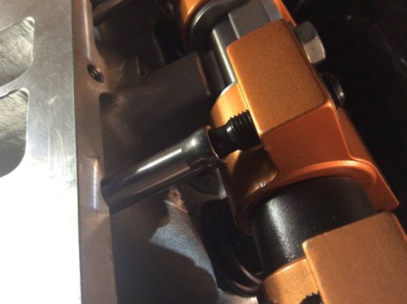

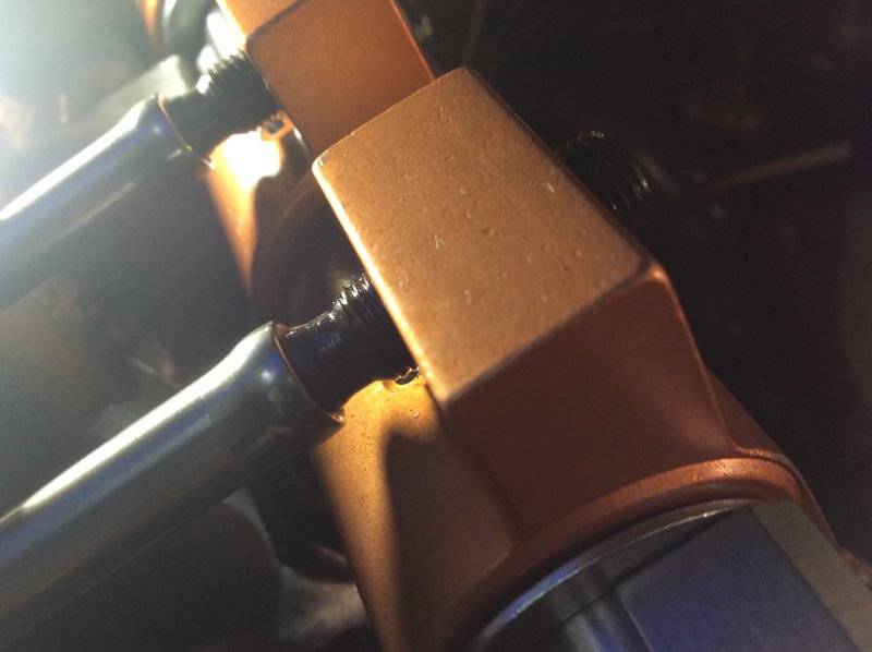

I’m in the process of installing my custom length pushrods and Harland Sharp Roller Rockers onto my 383 with upgraded edelbrock rpm performer heads. I think there are a couple problems I’ve run into where I could use the expertise on the boards.
First I had custom pushrods made because my OEM pushrods I was using with my older 915 heads aren’t long enough for the new Eddie heads. So now I’m have set up my rockers dropped in my used hydraulic lifters and custom pushrods. I was in the process of getting all the slack out for the rockers and was going to set the lash.
Now here is where I have issues. I noticed that on a couple of the lifters they feel very spongy and move up and down quite a bit. When I tightened them down I had to drop the pivot point on the rocker so low that it looks as if they won’t work and I can’t lock in the lash. On the other cylinders where the lifters don’t feel spongy the pivot ball only shows about 3 threads.
Is it because the lifters have been out for the car for some time and they are not pumped up? Or is that the lifters are going bad?
Should I order longer pushrods so that there are less threads above the pivot ball when setting lash?
I have included a couple photos showing how far I had to adjust to accommodate the spongy lifters and also the setting on the lifters that felt solid.
I just want to get the motor back together and keep running into obstacles as I am trying to learn. Thanks
Carl

That’s a lot of threads showing. I’d like to see 2/3 threads, that’s looks like 5/6. Might run into tapping from touching the walls. Did you adjust them on the base circle of the cam? Spinning them back and forth between your fingers until they get tight then adding the manufacturers specs is an easier way to go. Some will feel spongy unless you have primmed the oiling system, the stronger valve springs tend to push the oil out of the lifters after engine is shut off.

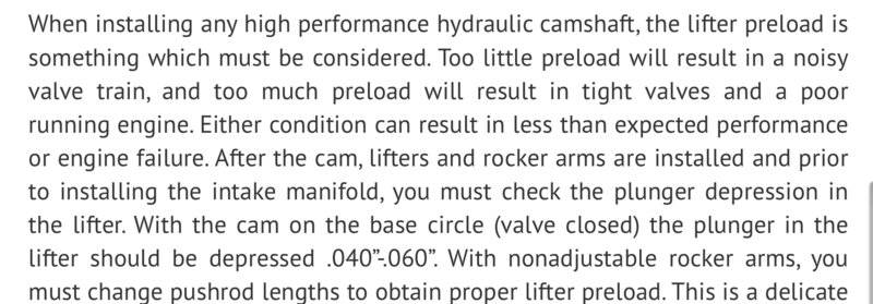

I copied this off of Comp Cams tech for Mopar. You have the intake off so you can see the plunger in the lifter which will help you to get a “feel” for where the zero lash is and then see the preload. The preload might be different for different manufacturers. The only thing I will add, and not trying to muddy the waters, is that some manufacturers used to recommend lifters that had a heavier retaining clip for the lifter guts. This was so that if the pre load was not enough and the plunger contacted the retaining clip, it wouldn’t allow the clip to pop out, which in turn could allow the plunger to come out of the lifter. This was many years ago and I’m not positive that it still applies today.

I hate to say it but it looks to me like your pushrods are too short, but it could be how you have them adjusted. The geometry of the rocker arms to the valve tips is also an unknown.
