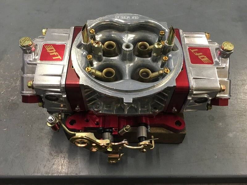

I have a new carb I put together a few years ago, but have yet to try it on anything.
I may mess with the emulsion a bit before running it.

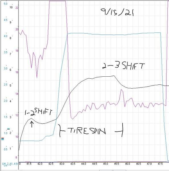

well 2nt gear stomp into 3d didn't quit spinning until 3d
saw tooth is still there..........but seam like a flatter air fuel ratio????????????????

I like the way it was flatter in High Gear.
Had to go make this stomp to see if it was going to lean out enough that i need to jet it back up............Don't think so..........

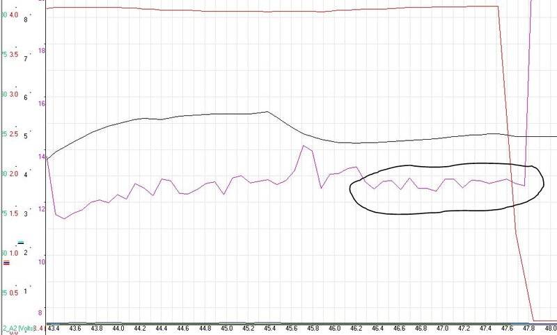

I agree. AFR now looks to be staying flatter under increasing load.
Change both metering blocks or just primary?
Now that it is flatter and staying in the 12-1 area, were before it was from high 13-8 to 11s. It made it hard to decide if i needed more or less fuel.
thinking of adding 2 jet size all the way around. To get it in the 11-1 ratio.
The curve looks like it’s “trending” lean to me through the run. That says to me that jetting is close and maybe an air bleed change to flatten it a little. Do you really want to be down in the 11:1 afr range? It’ll likely make best power up at 12.5:1 or so.
But is that AFR reflecting coming off pump shot and idle circuits?
Is the load, or lack of, while spinning tires affecting the combustion? yes. Is that in turn effecting the leftover oxygen or felecting an actual change in AFR?
That's hard to know about the early part of the first gear.
IDK. Guess I'd go 1 jet size all the way around, or maybe two jet sizes if just doing one end.
I mean there's nothing to suggest the overall mixture is far off is there?
To add to this. First gear was light throttle, enough to get it out on the road. 2nt was full throttle but spinning. 3d gear was hooked and loaded. But caught up to the car in front of me and had to lift.
