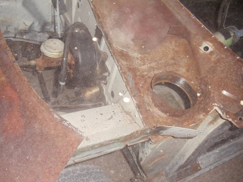

At 5:38 PM we found someone willing and able (hopefully qualified) to remove the cowl top to repair and refinish any rust-out. He called at 8:00 PM to report it was off. He said it was more work than he expected, finding the different layered construction and lead in the corners. After a quick sandblasting, we found some perforations around those round "chimneys" in the corners, could have been worse:
After a lot of debate, we decided to fabricate new pieces for the rotted lower and upper cowl areas. Here is the first foto of what should be quite an undertaking (upper cowl end piece):
A's are famous for cowl rot.
When I look at one for sale, I put my arm up the vent from the interior as far as I can get it.
Fixing it right is a really big job.
You have a dog fish.
We like it.
I'm a big fan of Rustolem Rusty Metal Primer.
I've always used that and not any of those "reformer" products or coatings.
I would strongly suggest Lord Fusor Crash Durable Adhesive for putting the new cowl top on.
No welding and you won't have any area for moisture once you get it on.
If you weld it, there will be areas that will have the paint burned off.
Someone has a thread on here doing that.
Cowl Rust! What is the best way to fix it?
I've done it too.
I had similar pin holes around the stand pipes and used polyurethane sealant on them.
No point in welding them. Who is going to see it anyway?
We like it.
If the pin holes are down to clean metal, couldent you temporarily tape it from behind and fill the pinholes w JB weld? Then use epoxy primer over the top to seal them in?
I've done it too.

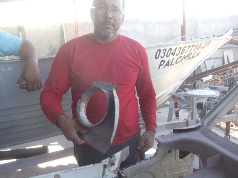

Another Cowl Update: First foto is the passenger side air vent cut out and in the hands of the fabricator. The next two fotos show his efforts to repair the damage to the "base" part and the "chimney" part.

Cowl Update: The two "hats/chimneys" have been fabricated all "new' using just one weld to close the "tube". The lower corner pieces received many patches of various sizes and shapes (see posting #36). The first foto shows after a treatment of "Naval Jelly". The second foto shows after the jelly was washed/brushed off using electric drill. Now ready to close welding pinholes with 3M panel adhesive followed by some primer.
