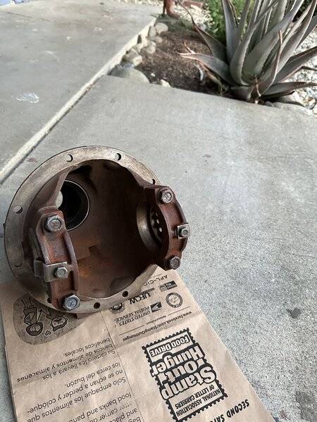

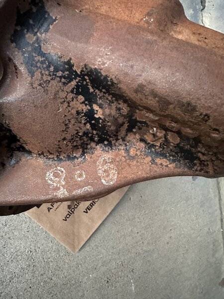

After pressure washing. I found some white numbers under the paint.
Hit it with a wire brush, still couldn’t get some of the factory paint off!

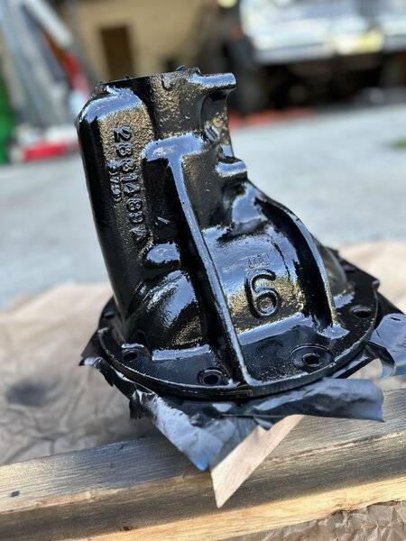

@MOPARMAGA I got the 489 restored to its former glory, time to stuff some 3.91’s and a sure grip in it.
That's cool, I love finding factory numbers on parts. Like the 4 speed you have those numbers were under 1/4 inch of crud
Me too. It’s crazy how some of those marking can survive the years of crud and corrosion. Then get hit with chemicals, and a wire brush,and they are still there.
Me too. It’s crazy how some of those marking can survive the years of crud and corrosion. Then get hit with chemicals, and a wire brush,and they are still thereb
Modern paint probably wouldn't hold on like that

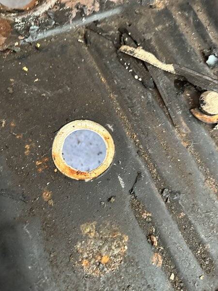

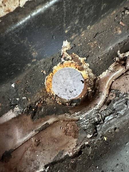

Interior pulled, body plugs and wire holders removed. You can see the PO didn’t remove the body plugs or prep the floor before coating everything in por15. Now I get to fix that mistake.
Got some help with the backing plates, they both love working on the “big block”, and resprayed the new housing.
Nice starting with a clean housing.
I sent mine to the local sand-blaster, he did a great job, well worth the $20 he charged me.

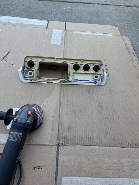

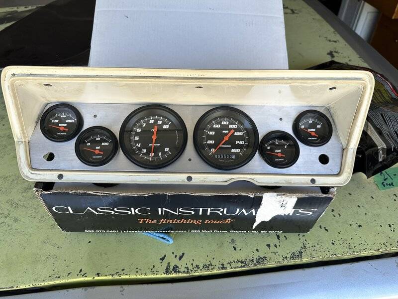

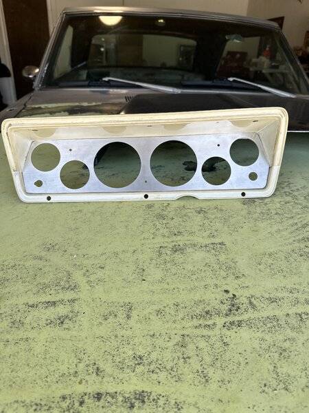

One more project started. The speedway gauge bezel fits like total **** in (my) factory bezel. Lots of fitting/grinding and now the brushed surface aint so pretty.
All good, after I epoxy the aluminum bezel to the plastic bezel I’ll be painting the whole thing. Maybe an appliqué? The interior is all black, so I’d like to break it up, maybe carbon fiber.

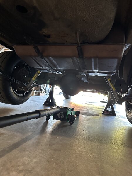

7 1/4 is out, had to do some sketchy jack/wood block maneuver to make it happen. Getting some help from a FABO brother building the 8 3/4 tomorrow.
Nothing looks sketchy on how you took it out, jack stands under the frame, let it swing down.
The same way I took the 7.25 out in my gravel driveway.
Bolted in new springs, paid my step-son and neighbor kid $20 to lift the complete 8.75 up in it, worth every bit of $20.
