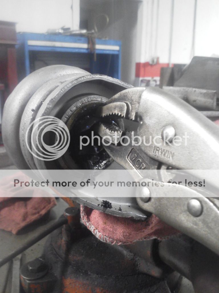

With the pivot shaft removed, now you will have to remove the lower control arm bushing and inner sleeve( on this build we will be installing a PolyGraphite bushing so we will be re-using the outer shell) Many people burn the rubber out, but a cleaner and easier way is with a heat gun. Direct the majority of the heat into the center in sleeve for a few minutes.
Now that the inner steal sleeve is nice and hot, take a vise grip and grab the inner sleeve and twist. The inner sleeve will easily come free. Once that is free use a pic or thin bladed screw driver and go between the outer shell of the bushing and the rubber center. Then remove the rubber with vise grips.

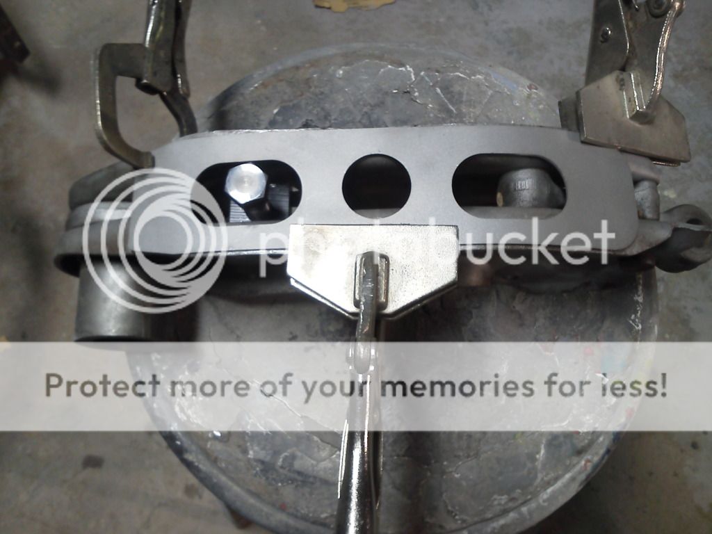

With the control arm clean and free of rubber, take PST's stiffening plate and center it over the back of the control arm. Make sure to have adequate room to allow access to the torsion bar adjuster and control arm bumper. Use multiple vise grips or clamps to hold the stiffening plate flush to the control arm

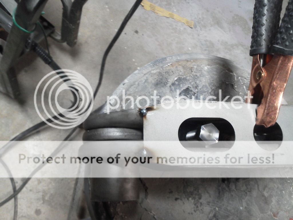

After double checking the placement of the stiffening plate make your initial spot welds to hold the plate in place.

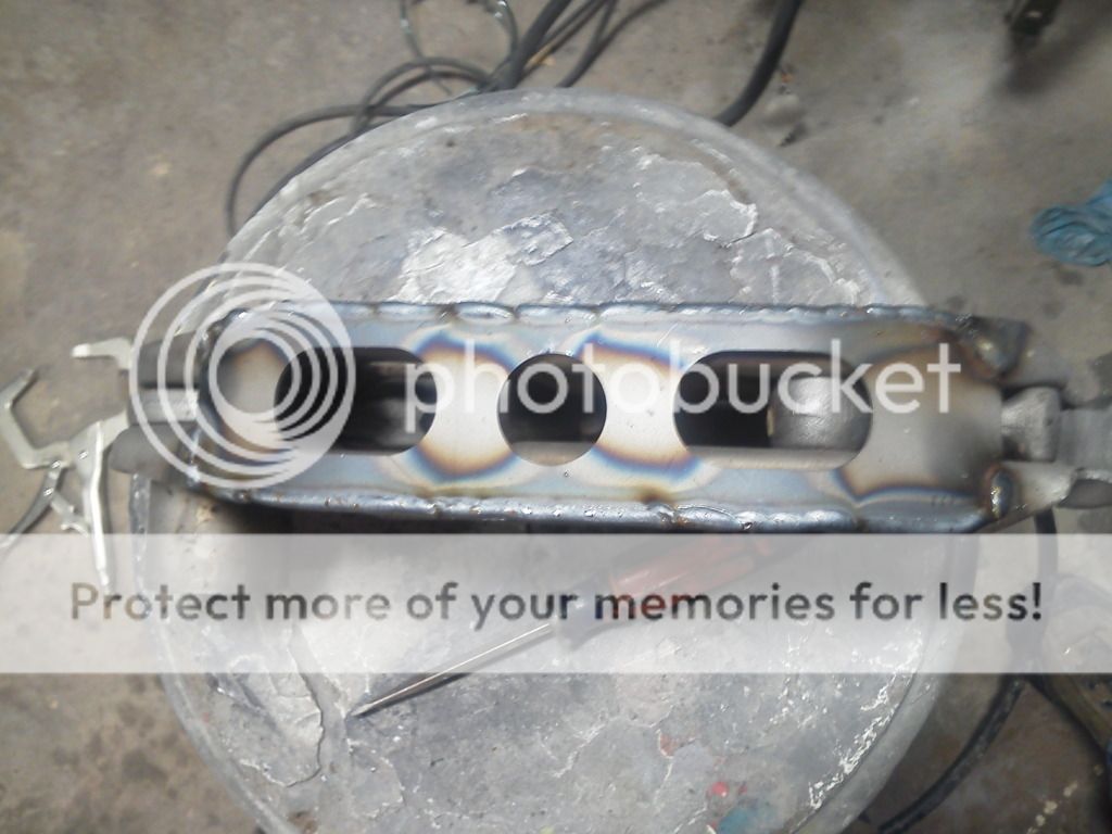

Now with the stiffening plate secured, start welding either side of the plate till completely welded.(Click on the picture to view video)
[ame=http://s671.photobucket.com/albums/vv72/JamesRFrom/?action=view&current=VID_20130224_122357_zpsa265f5bc.mp4]
[/ame]
Make sure that you have proper weld penetration of the plate to the lower control arm.
With welding completed it's now a matter of appearance, in this case I used a grinder with a sander paper flap disc and smoothed out the welds to give a seamless appearance.
