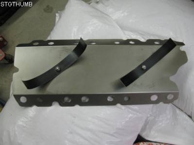

this piece was in the pile of parts and i figure it goes here but there is holes in the top of it but nothing in the top of the motor to bolt it down. also the back end fits perfect and i a smooth machine type cut. the front of it fits perfect as well but it looks like somebody cut it to fit on that end because its kinda jagged and sharp but is a perfect fit from what i can tell

That is a lifter valley baffle. The holes are for spring steel clips that rotate under the head lip to keep it down. You need those to keep it in. It holds the oil flung off the camshaft off the intake bottom and also keeps your lifters in place if you pop a pushrod, preserving your oil pressure. Ill post a pic of one with the right clips.

If you dont have the hold down straps, either figure out a fool-proof way to keep that baffle down, or pitch it. It will run fine without it. No worries.
thank you and ill look in the parts box for those metal clips and if not ill try to find some to buy
you could stud the block and run them up into the baffle, just locktite the nuts. You could even put some mattress coil springs on top and let the intake push it down.
if they are not there and i cant get a set cheap i will try a few things like pishta said and or just pitch it. i feel better about the push rod stuff as it looked weird and i did not really notice it that much in my 318.
