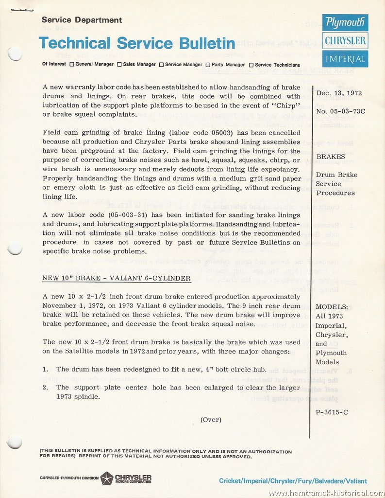

The ‘74 drum/drum cars all got the redesigned 10” front brakes, but the 9” rear drums were continued. So a ‘74 drum/drum car could have had 10” drums in the front and 9” drums in the back. All in the factory TSB…
https://www.hamtramck-historical.com/images/TSBs/1973/05-03-73C page1.jpg
