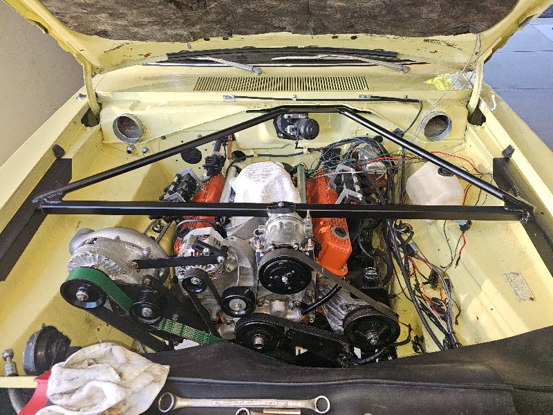

I realized I need to modify my crankcase ventilation set-up to accomodate the addition of a supercharger on my 408" Magnum. I had been running a PCV valve through an air compressor condensation trap, and it worked very well at keeping oil and such out of my intake. I'm stepping up to a Novi 1500 supercharger and figured I need something that can handle vacuum and pressure.
I found this online and wondered what others are doing for this situation.

I would call motion and ask. A buddy of mine looked into that for his turbo ls and they advised against it. It might have been because of the amount of boost he was running

interesting, I`m doing the same thing ,even have little ball valve to control the vacuum my outlets on the back of my throttle suck ...
