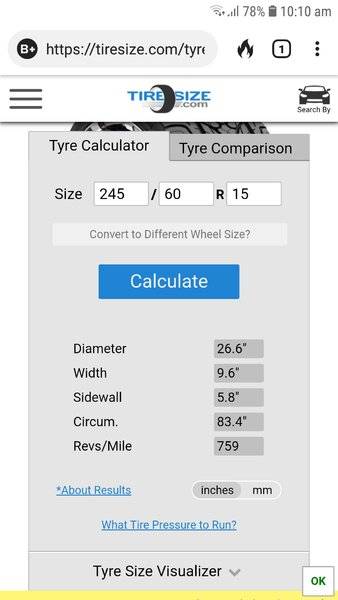

Hi guys, a while ago i swapped out my OD a833 for a non OD one, i believe it's a 1967 year and noticed a huge difference in 4th gear rpm at 60 mph. With the OD gearbox at 60 the rpm was at 2200, where as now it's at 3000 rpm. Diff gears are 3.45, tires are 26.6 inch, engine is 360 for what it's worth.
Just want to ask you guys if in your experience, you think this is normal?
Thanks.
Thanks.View attachment 1715895308 View attachment 1715895309 View attachment 1715895310

So I checked the diff ratio and it is in fact 3.45:1.
Tyres are 245/60/15 making them a 26.6 inch tyre. So perhaps I can swap out the rear gears for 3.23 which would help with the freeway driving or I can just live with it.
Driving long distance at 3000 rpm shouldn't hurt the engine should it?
We have a huge mopar show here every year and it's about a 4 hr drive away.
I will be putting 28 inch tyres on it soon which should also help.
