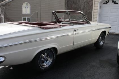

Well I took the Dart out for a15 minute drive varying speed from 25 - 50 mph I shot the therm housing 165 degrees the upper rad housing 175 and the lower rad housing 113 I change from a 180 to a 160 stat and the gauge didn't go into the hot area of the gauge I want to check it out on the highway and see where the temps come in at
I took the Dart out for a road test and drove about 15 minutes. I varied my speed from 25-50 mph. When I returned home my readings are as follows 165 at the stat housing 175 at top of rad and 113 at bottom of radiator. The gauge ran in the normal to high zone but didn't peg all the way to the right.

I took the Dart out for a good long drive. I changed the thermostat to a 160 the car is running a little cooler. After the long drive here are some of the numbers 174 at the thermostat housing, 182 at the top of the radiator and 126 at the bottom rad housing. The gauge responded by running at the very top of normal range not going into the extreme hot range if you know what the gauge looks like in a 65 Dart. I'm going to replace the water pump to a 8 blade impeller from the 6 impeller in there now. I have a question regarding the water pump. I'm able to grab the fan and turn the fan clockwise with little effort, however it is very difficult to turn fan counterclockwise. Is that the sign of a bad water pump? Once I have the water pump off I will back flush with a hose. Next will be recording the radiator if the water pump doesn't do the trick.

So I took the Dart out to a car show last night. On the way to the show the car ran well the needle didn't get to the extreme hot side of the gauge. Coming home with lights on the gauge stayed in the normal range, so now I'm thinking it is the gauge. I shot the usual spots when I arrived at the car with my temp gun and at the stat housing 164 the top of rad 194 the bottom of the rad 136 safe to say the car doesn't have a temp problem, thanks to all who read and responded....
