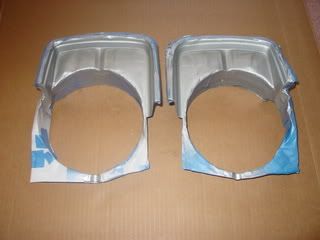

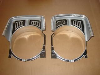

Wow. Just stripped, metal prepped masked (twice) and repainted my head light bezels. One word describes that job. TEDIOUS. Tomorrow I tackle the grill. The body shop called and I may have the dart back within a month so I have to get the trim done. I sure hope the grill is not as bad as that was. Cutting out all the lines with a razor blade is painstaking work. I often wondered why some darts had a solid black shape instead of a finned one. Now I know, Its a pain in the arse the way I did it.
Might be a pain but the difference between a nice car and a sweet car is details like this. Great work!

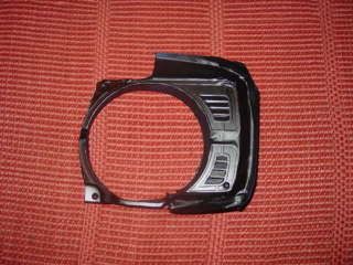

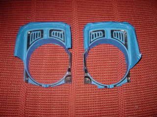

I did mine this summer too. It started out as an experiment because I wanted to try and buy a better set that weren't as pitted and dented, then when I had about two hours of work in it I figured I better continue and make it as good as I could. I ended up doing the grill as well and it took a lot longer than I thought it was going to but I was pretty happy with the results. Here are some pictures of my process.
Some 0000 steel wool then some polish on the chrome areas does wonders. Like lilvaliant said use a real sharp xacto blade and press the tape down tight into the raised areas. I think if I do another one I will make it a GTS style and only have the one silver stripe around the outside.

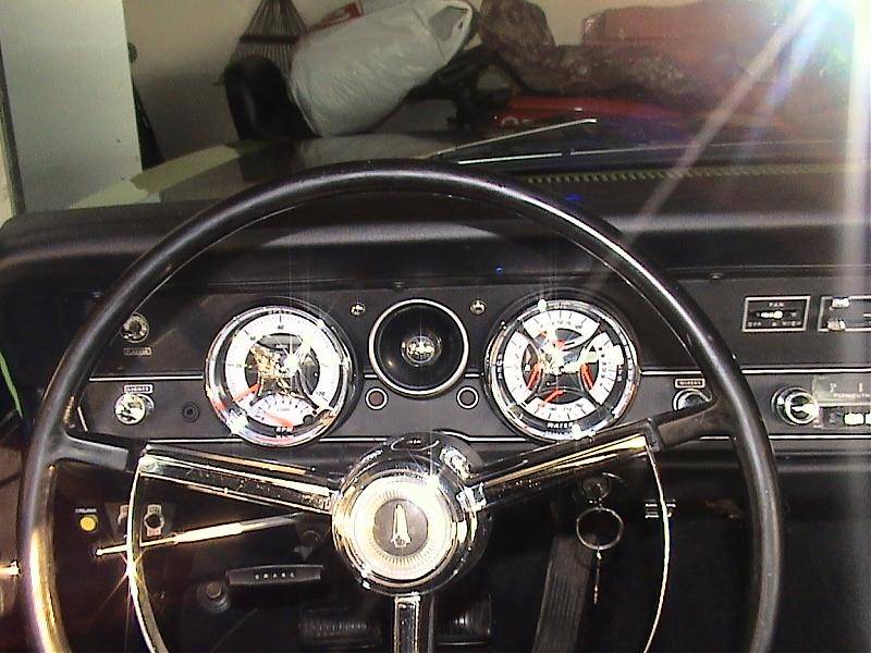

this is the message regarding what he used on his dash...
I used a pen. I got it at a hobbist shop called Michaels. The pen is made by Gilmers (the glue people). The pen has "PAINTERS" wrote on it in big letters. I used the color metallic silver argent.
i have not used it but it looks great and i will try it soon on my dash and front end
