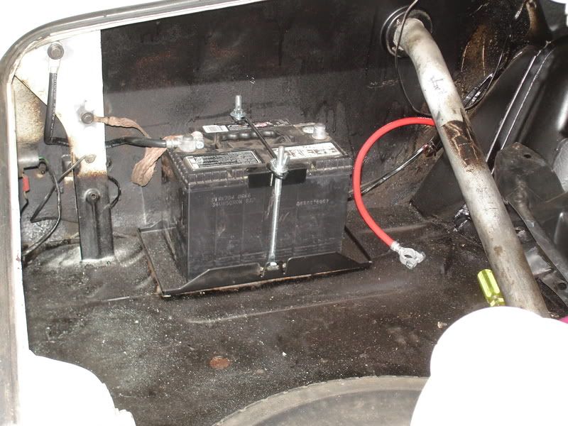

hi guys ! my friend relocated my batterie in the trunk for the weight ratio.. ive seen a lot of mopar cars who ad the battery on the passenger side .. is it that bad that i was installed on the driver side ? do i have to put some weight on the on the other side ?
Well it belongs on the right side. Adding weight when you can move the battery is well.....adding weight.

why and whats the diffenrence ? 67Dart273 : said is on the good side , and thats the reason on my thread.. i was asking why other people are installing it on the passenger side
Not 100%, but I think it has to do with the fact that when you launch, the driveshaft/pinion rotation will tend to cause the right-side to lift. Putting the battery on the passenger side simply helps keep that from happening as much

Yup. Every rear wheel drive car I've ever seen turns the engine CW viewed from the front. I don't know if some rear engine cars are different or not.
The twist of the torque of the driveshaft literally tries to lift the rear axle off the ground, or plant that side of the body down on the axle, depending on how you want to look at it. "Torque reaction."

Now, weight distribution? Why would you want to add weight on your already heavy drivers side? No offense, but YOUR body weight is already there... and you're not changing that fact too easily... Your left/right weight bias would be better with it on passenger side.
Another thing 67Dart273 hit on is engine rotation. Your rear axle isn't just applying power to the wheels... The whole housing is trying to rotate under your car, just as the driveshaft is. That's the reason open rears light up the right rear tire. They're planting the left wheel hard and actually trying to lift the right.
