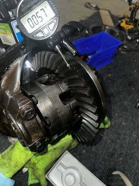

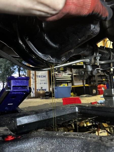

I pulled the 3rd and there was a lot of junk in the fluid, probably a lot of the surface rust and other junk that flushed with the gears. The backlash measured around .015 which is more than what the FSM calls for.
I installed my 3rd with 3.23s it doesn’t pull nearly as hard but it doesn’t annoy the **** out of me with the loud pig squealing sound.

Think it the pitting...
Does the pinion feel smooth....might just be a bad bearing
