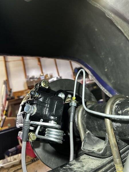

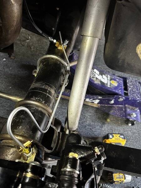

Capped rear port on MC (sends fluid to front brakes) and pressed pedal with main line detached from each rear caliper; first passenger side then second drivers side. Fluid comes out of the line with ease.
So… culprit is one of the rear calipers I would assume?

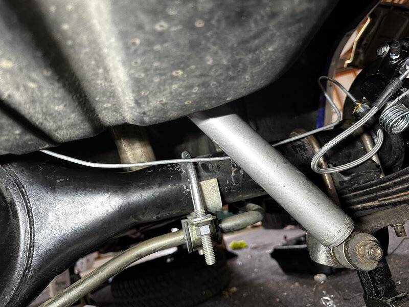

First picture is the passenger side hard line broken from the soft line and the second picture is the drivers side hard line disconnected from the soft line.
Cap both rear hard lines and bleed. How does the pedal feel?

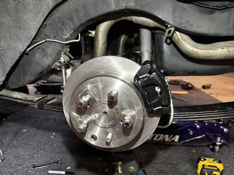

Scrapped the used rear brake kit and threw on the brand new kit from DrDiff. Bleeder screws in the correct position, lines in the correct spots everything new! The hard lines are new inline tube line to the rear and self made lines over the rear axle.

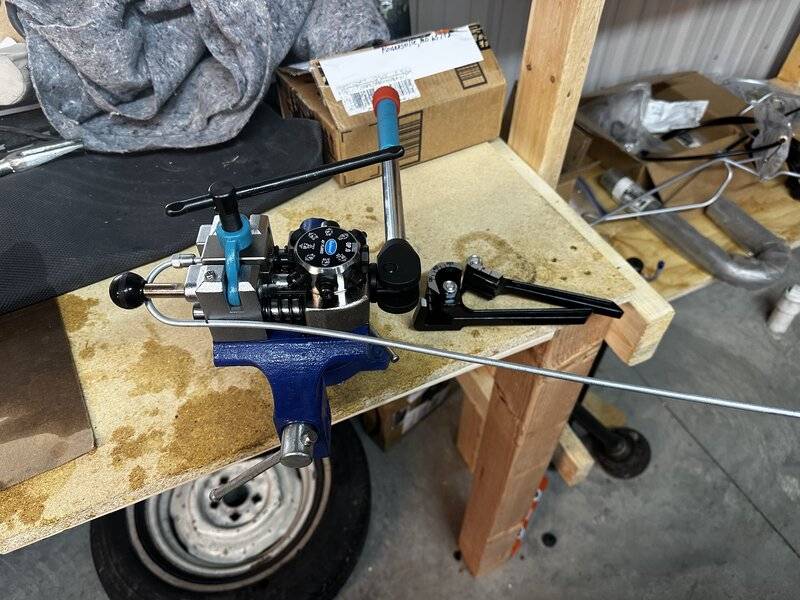

The brand new line that goes from the distribution block to the rear line was pretty short. I had to take all the bends out of it but what ever it’s on and it’s hooked up, it will never move.
The other hard lines are hooked up too. The new brake caliper mounts, calipers and soft lines went on super quick in the rear. The most time was spent bending new lines to go over the rear axle as the breather is about 4 inches offset between the copper darts 8.75 and the purple darts 8.75. They are done though and yes, the flares are perfect, even for the not so smartest car technician.

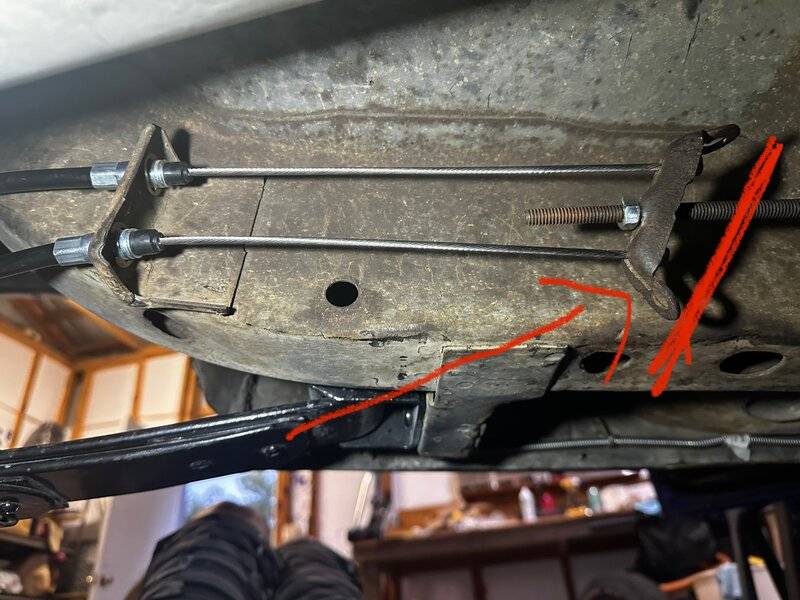

As the the bracket, the bracket where the E-brake cables on the rear and connect with the cable from the handle. It’s not straight.

One cable is pulling more then other

Make sure the lever on the calipers is all the way in the returned position. I also had to move my pass side cable around to minimize the sharpness of the bends.

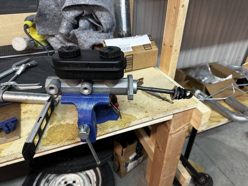

It’s either a bad MC, bad distribution block, or the rod being the incorrect length (even though I put the measurements at full extended and fully pressed into the MC). Or I guess it could be a front caliper, the front calipers are the only ones that do not quit moving.

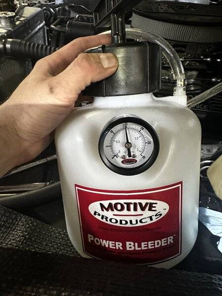

My system has no leaks, my pressure bleeder leaks 0 pressure after being at the same pressure for 20 minutes.

Motive power bleeder holding pressure.
Last new MC I have at my house with the stock rod and my last little rubber grommet. I’ll buy a couple more from DrDiff.
