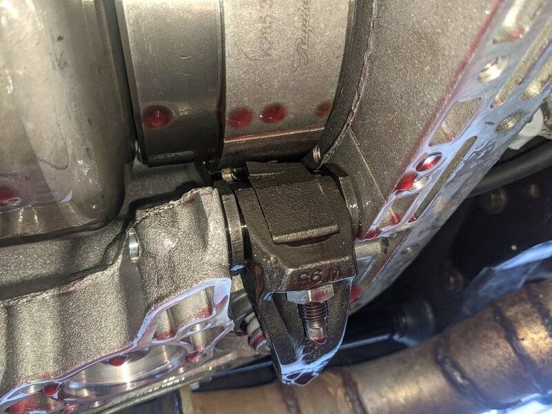

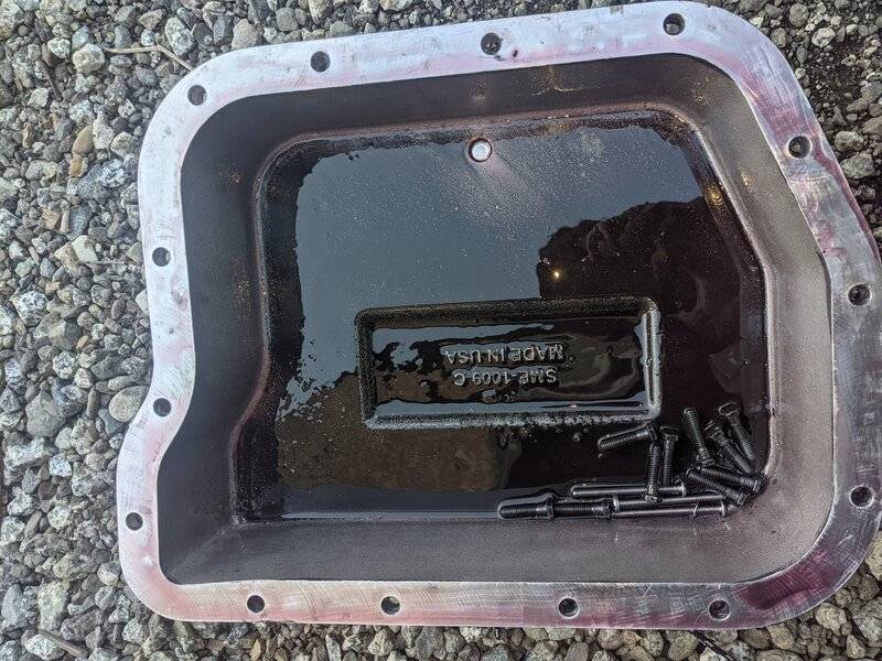

Popped the pan off to find this, tell me what u think. Looks like the band adjuster arm is cracked halfway through, how would that happen
Yup she is cracked. U will need to take the tail housing off to get the pin out to change it. By the look of the black dust in the pan it should come apart to check it over. The crap could of been in ur rad cooler and got flushed into the trans of its coming apart inside. Could also be the lining off of the rear band. Kim
Yep rear band stuck on. Servo piston is locked in applied position.
Pull it , rear band and band drum are toast.
the low/Rev servo looks weird to me. I can't tell for sure, because the picture is just barely showing it. what do u think, Kim?
The complete white spring is below the retainer, it should be flush with the case when servo is released, piston is cocked at a angle and bound up!

I can't tell about rear servo piston being billet or not, but the apply arm pocket is not a sonnax billet part, it does have the billet intermediate servo assembly, it is the red cover part.

Rear band lock up is usually caused by high line pressure, high idle apply in rev. or a loose rear band adjustment causing it to **** over and jam.

Rear piston is out way to far. Usually the rear piston is not out of the bore that far b4 it gets cocked over. The adjustment was probably way to loose to start with. Hard to tell if the rear spring is even in the case. Did u put it into reverse when it was on high idle? It is definitely not a billet rear piston. By the colour of the spring it is mid 70s. Kim
Probably forgot to put the big spring in there. I went back to the very first pic Mark posted. The bid spring is in there and the servo was t hanging down like it is in the later pics. His list says billet 2nd and 1st billet servo. So he got screwed over as the rear servo us definitely not a billet servo. Kim
yeah, maybe the reverse servo return spring is either missing or possibly broken.
I think if someone had forgotten the return spring, it would have been apparent if someone ran an air pressure check before the valve body was installed.
This Story is just a nightmare. You cannot put the rear band strut in the wrong way, it won’t fit. Looks like a stock servo that is stuck in apply position.
