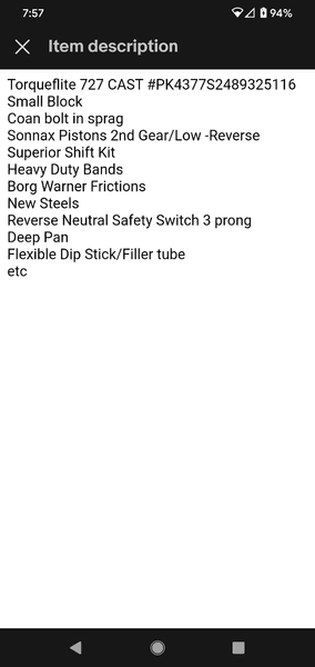

Also was planning on buying a new valve body through crt and it says it requires billet low/rev servo kit.
When I bought this transmission this was the info I had of what was done to it. Should I still buy the crt billet low/rev kit or stick with what I have?
Also having trouble decoding it
Sonic should be billet. Says it had a deep pan. Make sure it has a bolt in sprag. Kim
Okay, so I'll hole off on that but yeah it had a deep pan but I had a cast aluminum deep pan. It's like he rebuilt it and threw parts cheap on it. No filter extension on it either. How do I check for bolt in sprag?
Trans needs to be apart, outer race of the rear roller clutch will have bolts going through rear of main case in the gov support holding it in, factory was just pressed into case and a set screw holding it in.
