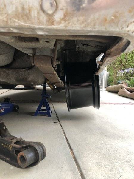

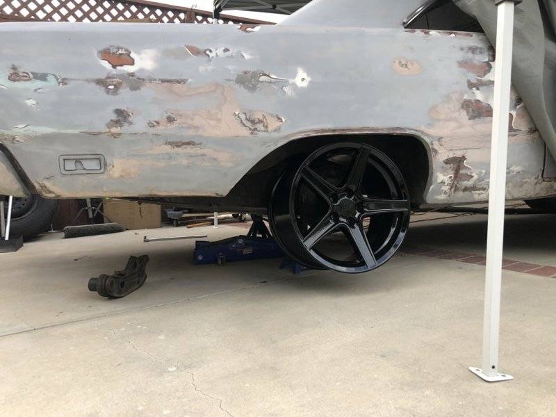

im sure this thread has been created before but I couldn’t find it. I have a 69 Dart with stock spring location. I’m putting a Ford 9 inch built rear end in my car and I want to move my rear springs inward. Is there a kit that does this? Is there anything I should be worrying about when it comes to the narrower suspension? All the work is going to be done professionally when it comes time. As you can see from the photo with the original rear end, I have a fitment issue and these are the wheels I will be running.

View attachment 1715387528 View attachment 1715387529 im sure this thread has been created before but I couldn’t find it. I have a 69 Dart with stock spring location. I’m putting a Ford 9 inch built rear end in my car and I want to move my rear springs inward. Is there a kit that does this? Is there anything I should be worrying about when it comes to the narrower suspension? All the work is going to be done professionally when it comes time. As you can see from the photo with the original rear end, I have a fitment issue and these are the wheels I will be running.

I don’t think ill need to mini tub due to only running a 10 inch rear wheel and tire. I’m looking more to autocross and canyon run this car rather than drag race it.
I looked at car tool and that looks like the company ill be buying from. I think ill buy the chassis reinforcement kit level 2 so I get the torque boxes as well!
It might be different on my duster, but my springs are relocated. Without a mini-tub it wont get you any more than running offset hangers since you will still run into the factory wheel tub before a relocated spring. Unless you plan on jacking the rear way up.
I should be more than okay with the wheel tubs as they are as my wheel is only a 10” and I don’t plan on running anything wider for now. But I know if I wanted to go larger I would have to mini tub
I can only speak from experience that an 18x10 with 6.5 bs with a 285/35 still kisses the tub when cornering if you plan on the back being low. And I think the general consensus is the dusters have the most generous factory wheel tub. If memory serves, the hemi darts came with offset hangers and people crammed a 15x10 in there, but I think they were on SS springs and not worried about turning sharply much.
