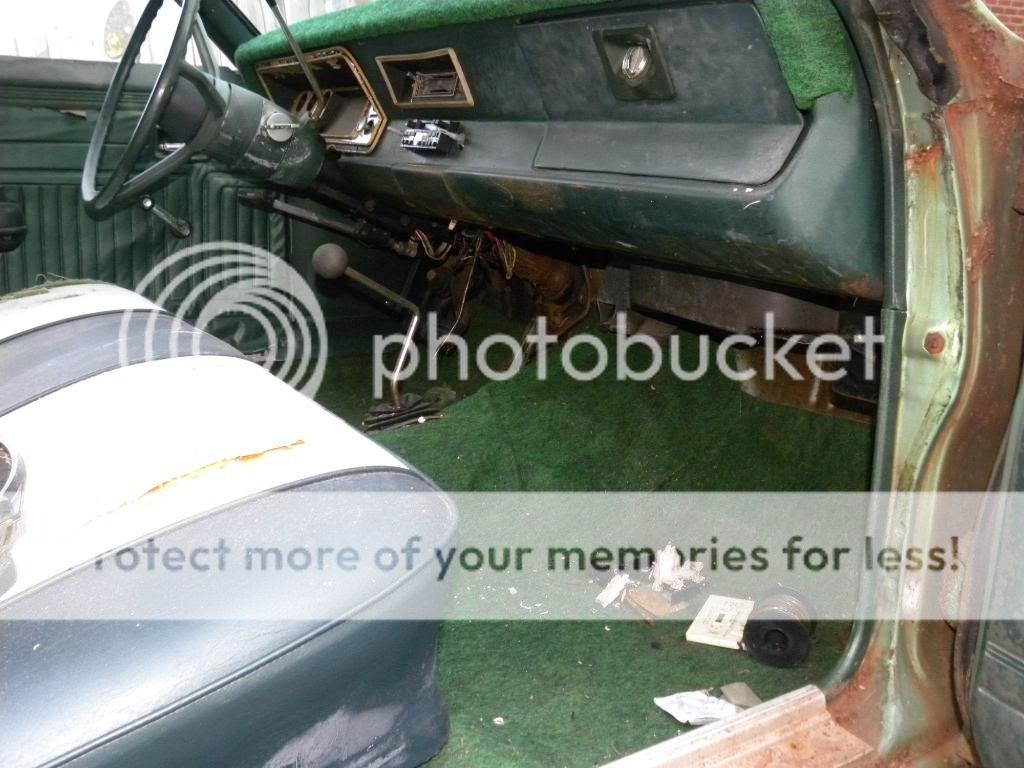

The cassette tape in the floor board was absolutely hilarious to me.

Best of luck on this project!! Sounds like you already got it!:cheers: Nice cassette, love that record. lol. Musta been your gramp's or your dad's, that one is the same year as your car, Im sure you will find some more interesting stuff as you go

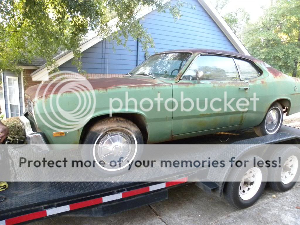

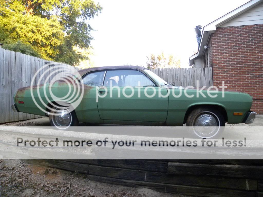

The rust doesn't look too bad if it is only on the outside. Worst is when your have rust-thrus from the inside, usually first behind the front and rear wheels. I don't see that. It looks like the sun degraded the paint on horizontal surfaces and then they rusted. I would use a wire brush on a drill to remove it on the outside (safety glasses!), especially on the C-pillar, to see how pitted it is. If lucky, it will clean up to smooth metal fairly quick.
Once you get to bare metal, you can spray rattle-can primer. I suggest a "self-etching" primer. But don't paint over rust pits - they will return. If you can't brush out or sand the pits away, look at rust-converting primers to seal it in the pits. If you can't put in the effort yet to get it ready for primer, a neat product I just started using is Rustoleum Rust Inhibiter. It is a clear petroleum product in a spray can, I guess between WD-40 and the cosmoline grease they coat military rifles with. The advantage is you can remove it easily when ready to do a full job. I spray it on nuts and bolts after I wire-brush the rust, but don't want to paint and wait days to install (and lose them).

Thanks for all the positive comments and tips. Has anyone heard of a product called Osfo, I think that's what it's called? That's what the guy that hauled the car recommended. I plan on starting next week. Any specific kind of wire brush Bill? Thanks in advance.
Cool, another heirloom and another '73 resto. Paint (and rust) looks a lot like mine before I buffed it. Not a lot of paint on those '73s.
You are going to want to use the Ospho on non- finish painted surfaces (think floorboards, chassis, etc) and strip that rust abrasively. The way rust pits the surface, it's a big risk that it will bubble later. My Beetle painted 8 years ago is proof.

I buy a pack of ~6 assorted wire brushes for electric drills at Harbor Freight on sale (~$4.) Usually the disk ones work best, and the small ones for inner corners. When the rust is minimal, it comes off as fast as you move the brush. Sometimes it looks bad, but cleans up fast. If pitted, you can work a long time and never get all. Then have to look at rust converters and epoxy fillers (Bondo). As you work, some wire bristles disappear. Some fling towards your eyes, so wear good glasses, goggles, or face mask. Before priming go back over with sandpaper and/or Scotchbrite, and clean with solvents like alcohol, laquer thinner, MEK, or acetone. Also, first clean oil or grease with gasoline, kerosine, or mineral spirits.
