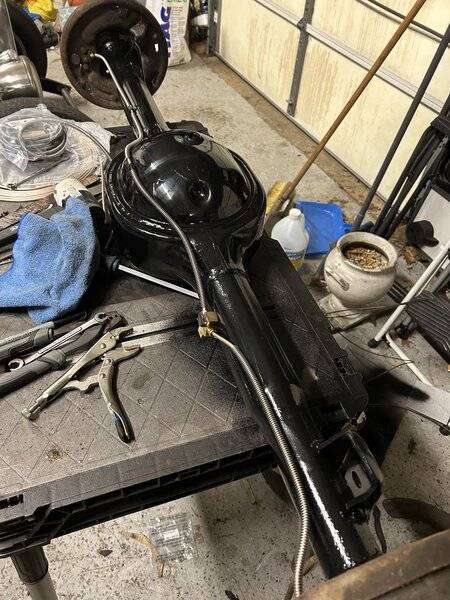

Now that sheetmetal stuff had been addressed it was time to get after mechanical stuff. I started with a new fuel tank and sender followed buy a new set of super stock rear springs along with an 8 inch for rear axle swap. I know it’s not the best rear in the world but the 64 mustang unit I had was dimensionally the same as the 7 1/4, it had a 3.25 gear and a trac loc in it and I already had it, and was way cheaper than rebuilding and swapping to a big bolt pattern on an body 8 3/4.

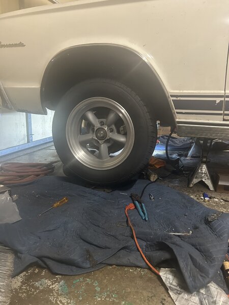

With that done and installed it let me check the wheels I had slated for it. 15x7 torq thrust D rims and 255 60 15 tires. Yes the fit after rolling the fender lips.

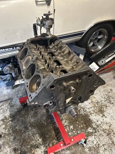

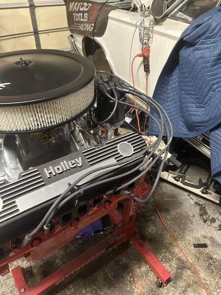

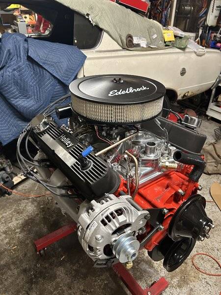

I was able to find a 2000 5.9 magnum on marketplace for a real good deal. Plus with all the parts that Lynn had collected through the years I had most everything I needed to put a 70 LA timing cover and pulleys on it. I picked up a Chinese air gap intake and a nice set of NOS Holler black crinkle valve covers. I tore the motor down to short block to inspect the bores and all looked good. I was he. Pulled all the lifters out and disassembled them cleaned them completely and reassembled and checked the preload.
Once I got the engine cleaned up, a little clearance grinding in the drivers side head for the early manifold to clear and swapped on a 70s 360 oil pan it was ready for paint and final assembly. I used Chrysler industrial red, as it’s my favorite one with 2 k clear o. Top.
I did switch the alternator out to a single groove pulley one before I got the engine I. The car.

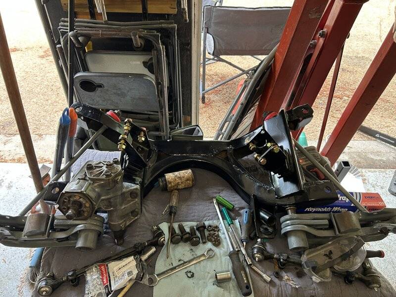

A little out of order but by this point I had already stripped repainted and rebuilt the front suspension, a set of 75 dart discs and installed a new flaming river steering box Lynn had bout 20 years ago for it.

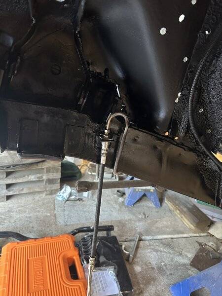

With the motor and and the front K member wrapped up it was time to move on to brakes. I made all new Brake and fuel lines with rolls of Nicop tubbing and stainless graven guard.

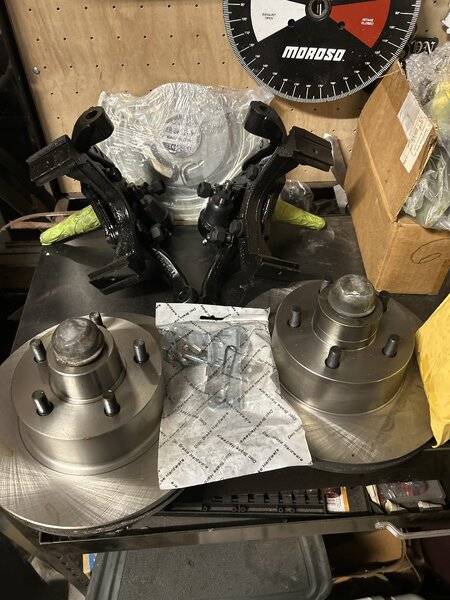

I had already done the rear axle when that was put together. I used a stock rear brake hose and ended up swapping the front brake hoses to 73 B body brake hoses so I didn’t have to deal with the steel tube coming off the caliper. The calipers would be put on the back side of the spindle so as to clear the sway bar In The front

For putting the motor to the K frame I used a set of Schumacher Creative Services motor mounts and man those made it easy. Now that the motor, trans and K member were back in, it was time to wrap up the odds and ends to make it run and drive. I got the discs installed with the rebuilt upper control arms. Then got the throttle linkage worked out by cutting up a factory throttle/kick down linkage bracket. I used a Lokar kick down cable kit because I just could not come up with the right combo of parts to make it work right. For a radiator I used a Jegs brand aluminum radiator for a 70 b body with a 22 inch radiator. At 250 bucks it is way nice and fits pretty much perfect.

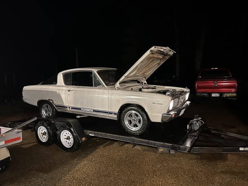

By 1200 Friday August 1 2025 I had cobbled together an exhaust using flexible tubing got it together enough to drive it half a mile around in my neighborhood before loading it onto the trailer to leave for Alabama in the morning. I was blown away at how great the car looked on the trailer and I knew that Lynn would be very happy to see it in its new state
