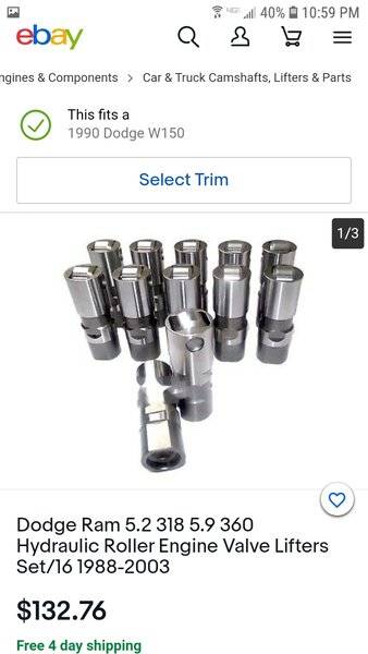

The ones in the link below are what I'm planning on using in my 273.
My machinist says he thinks we can get the pushrods to clear with the 302 heads.
These are not supposed to needs the lifter bores bushed, so we wil see.
CHRY HYDRAULIC ROLLER LIFTERS 5321 (straubtech-morellifters.com)
