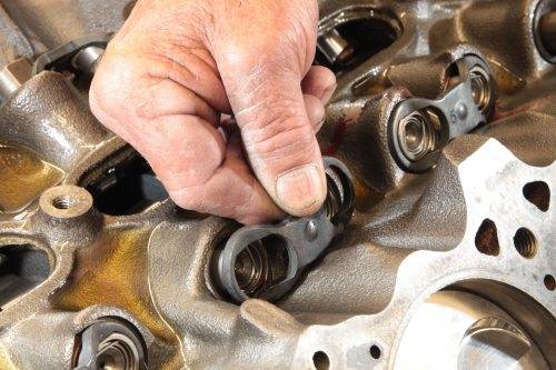

My blocks date stamp was 08/90. So maybe for an early 91 model.
5.9 (360) Magnums came out in the 1993 models I believe.
The LA roller and Magnums use pretty much the same roller lifters.
The setup is exactly like this:
With these "dog bone brackets".
Yeah, Chrysler sure knew what they were doing when they designed and built these. I've had little to no problems with these stock roller lifters and they're actually pretty quiet.
*I lucked out with mine*, so I didn't need the hydraulic roller retrofit kit. And from what you folks are describing, not a good investment.

Know I understand
That is a far nicer setup that the retrofit rollers.
